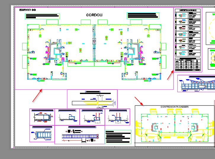

MastroLube Posted October 18, 2016 Posted October 18, 2016 Hello everyone! I've a little question.. Is it possible to fit a viewport to an object? The scale has to be the same. I've recorded a little gif to show the behaviour I want to obtain. Have I to write a little lisp or there is a command in autocad? Thanks you for the help! Dennis Quote

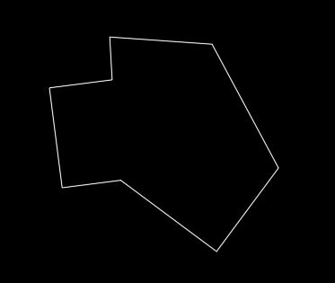

ReMark Posted October 18, 2016 Posted October 18, 2016 What's wrong with the way you have demonstrated above? I don't see that as being all that time consuming. On the other hand if you had an object shaped like that which I show below then I'd say it would be a bit (a tiny bit) more challenging but certainly not impossible. Quote

MastroLube Posted October 18, 2016 Author Posted October 18, 2016 Hello! I've 7 papers with 3 (or more) objects to fit for every project I do.. As you can see in the gif in the 1st post, the way I use is not very fluent Anyway I need a lisp, right? Quote
ReMark Posted October 18, 2016 Posted October 18, 2016 Depends on your what you mean by the word "fit". I'm guessing you want nothing more than a rectangular viewport (smallest size possible) and not one that matches the outline of the object exactly. Is that correct? Quote
MastroLube Posted October 18, 2016 Author Posted October 18, 2016 (edited) Maybe you should take a look at Viewport masterIt keeps (a visible) relastion between modelspace and paperspace. Works good for 2D work. http://u-cad.eu/apps/viewportmaster/ Thanks for this! @ReMark yes, you're right! I use to draw the boundary of my objects (it's always a rectangle) in the model space in order to fit them. It will be very cool if there is a way to link the viewports to these rectangles in model space. Objects like the one in the gif can change over time.. Ok, I'm asking too much Edited October 18, 2016 by MastroLube Quote

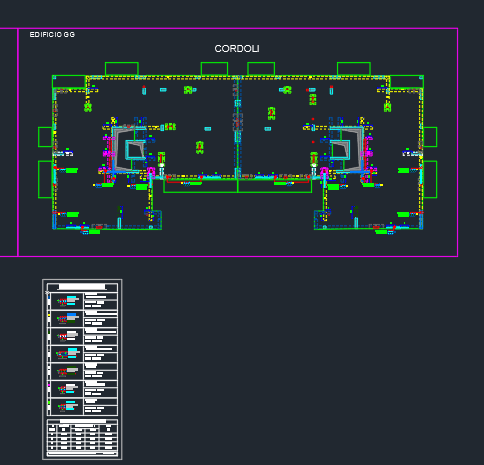

BIGAL Posted October 19, 2016 Posted October 19, 2016 You can pick two points work out centroid go to layout make a mview then use zoom c at a scale or if you want it to fit using a lisp. Manually why not viewport zoom c pick point, scale. or use zoom num/xp. You should have a pretty good idea of the scale required depending on the size of detail with experience. Just me I make viewport, zoom it to about full object required then I check the number in the "viewports toolbar" this tells me the current scale factor so I can adjust. eg if it says 9.82 then I would type 10 in box and it would be 1:100 exact (metric) and just slightly adjust the viewport border if required, but its true plot scale ie like Robdraw. Quote
Dana W Posted October 19, 2016 Posted October 19, 2016 Since setting viewports to not plot is standard pretty much industry wide. I see no value to this at all.Exactly. Draw the rectangle (frame) in modelspace or even paperspace if you must have one, then with your viewport on a no plot layer it doesn't matter where the viewport is, as long as all the unwanted model images don't show, and the wanted ones do. This is probably why AutoDesk has never rushed to make a viewport alignable with osnaps. There's no real point in it. Quote
