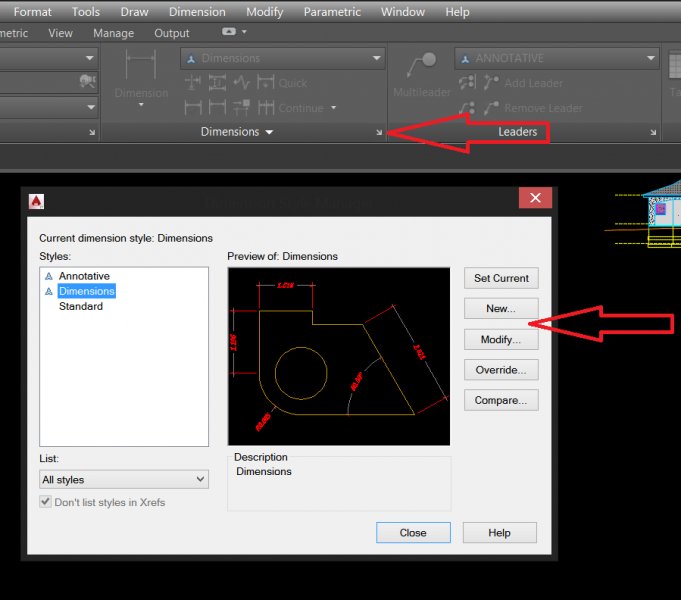

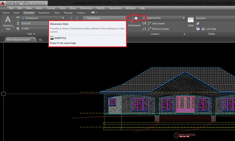

Dana W Posted October 18, 2016 Posted October 18, 2016 (edited) Alright then, 2016 it is. In that case, hit this dropdown list below, on your annotate tab and see if there is a dim style that fits better. (do not tell me you don't use the ribbon, nobody in my class doesn't use the ribbon.) Of course you could always execute DIMSTYLE and do the same. Once you open the Dim style Icon display, if there is not one that works, click the lower right corner marker on the dimensions tile as shown in the second image, and make a new one or modify the existing one you are using. Once again, DIMSTYLE gets you the same dialog. In order to get to what DIMSTYLE does from the dimension style icon display you have to click on Manage Dim Styles below the dimension styles icons. Edited October 18, 2016 by Dana W Quote
Dana W Posted October 18, 2016 Posted October 18, 2016 If none of the above helps, I suggest you look for a zebra in the Annotative Dimensions jungle. Annotative dimensions are easy , but they look very very difficult for about a week or more, then bang, the concept hits you between the eyes. It is nothing more than getting your head around what scaling does, and why the dimensions do what they do when they are annotative. Simply put, in a viewport AutoCad scales everything BUT the annotative objects. They will always plot the same size in paperspace. So, one builds an annotative dimension style with EVERY part, including text height and all, exactly full size. So, if you want the text to be 1/8" high in paperspace, make it that high when building the dim style. Quote
