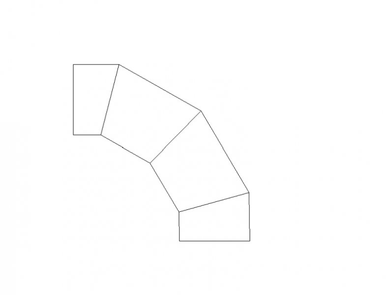

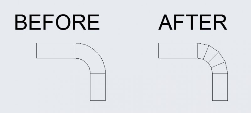

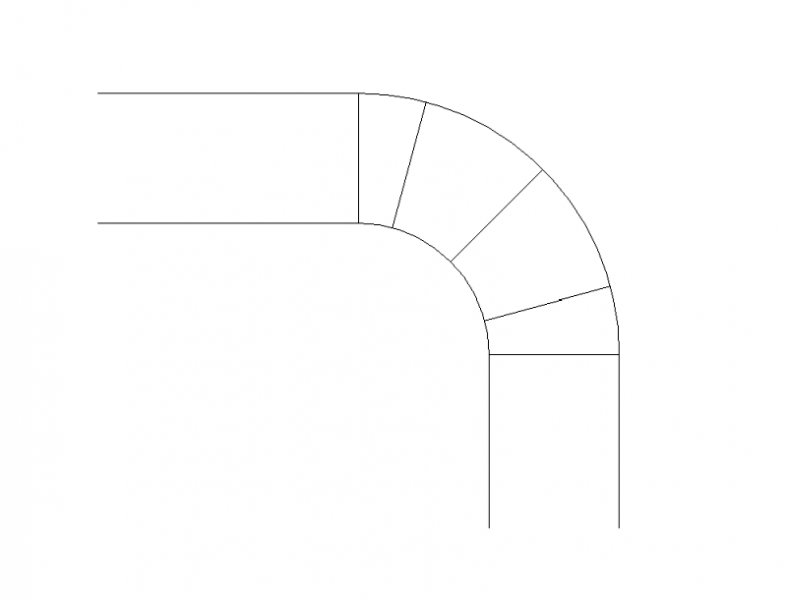

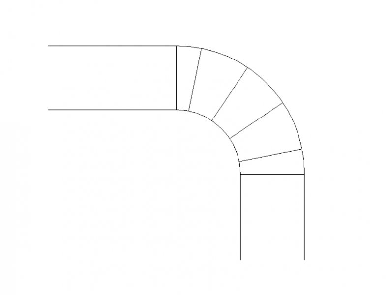

danglar Posted October 13, 2016 Posted October 13, 2016 Hi All! I need to convert radius elbow to segmented like shown in a picture.. (see attachments) I find the appropriative routine to convert arc to segmented pline with user defined number of segments (see attachments) and now I need a little improvement in this program to draw line or plines from segment vertex’s to center of selected arcs Can somebody help me to do it? Any help will be very appreciated Arc to Number Segments - ASX.lsp Quote
David Bethel Posted October 13, 2016 Posted October 13, 2016 Wow. It's been a long time since I developed the patterns for a gore elbow ! 1st thing : The 1st and last gores are 1\2 of the middle full gores In the states, we use ( used ) SMACNA as HVAC Standards as to radius of the bend vs the size of the round duct. The number of gores is determined by the application of the system. Dust collectors require a lot more gore than standard ventilation. Do you have specifications that you need to meet ? -David Quote
danglar Posted October 13, 2016 Author Posted October 13, 2016 I understand what you mean, but I have not any specifications and on the first "dirty" stage I need only line connections between gores in a direction of arc center Quote

danglar Posted October 13, 2016 Author Posted October 13, 2016 I have a bunch of already drawn radius elbows in a set of drawings and I need to "convert" it without redrawing at all Quote

Ronso Posted October 13, 2016 Posted October 13, 2016 I have a bunch of already drawn radius elbows in a set of drawings and I need to "convert" it without redrawing at all Regarding the radius elbows, What autocad objects are they comprised of? two separate polyline arcs, two separate circular arcs, or one continuous closed polyline. A bit more than a just little improvement when the routine you provided can select a multitude of object types. Quote

danglar Posted October 18, 2016 Author Posted October 18, 2016 Nice approach David! Thank you, but I already have the "final" solution of this issue. You can see it here: https://lispbox.wordpress.com/2016/10/18/convert-radius-elbow-to-segmented-with-user-defined-number-of-segments/ Quote
David Bethel Posted October 18, 2016 Posted October 18, 2016 I cannot get the lisp file to load but I have seen references to it before. While I believe it can create the equal segments, that is not the correct application with HVAC round gore elbows. It would be if using tubular pipe ( image attached ) Quote
danglar Posted October 18, 2016 Author Posted October 18, 2016 I understand and realize that this Lisp does not quite correct separation to gores, but in the case, you mentioned it may be acceptable Quote
