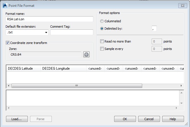

Managed to get it to work with the attached geographic co-ordinates and .txt file format. Did notice that Civil3D is very pedantic about the file format.

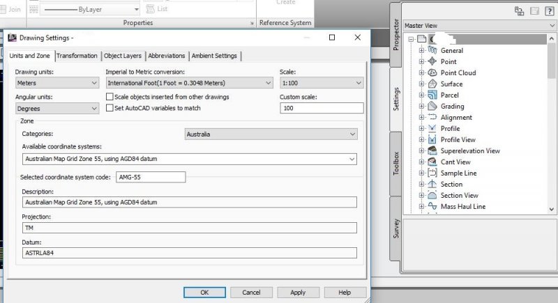

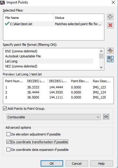

Ok I have only just found the answer late yesterday and its a bug in Autocad which I will post some images etc, it may be a version problem. There are two ways of setting your zone to be used, 1 in the point import screen as posted by Spaj. The second is in the drawing settings.
Now the answer for me any way with 2016 CIV3D original no service pack. Do not fill in the zone details in the point import screen ! Fill it in the dwg settings. Then when importing points I used a file .LAT P lat long Z D etc click do co-ordinate conversion and it worked fine.
Spaj you may have it set there also.
