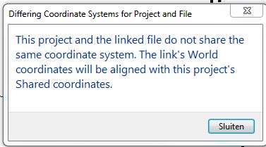

halam Posted October 11, 2016 Posted October 11, 2016 (edited) Revit indeed is very SPECIFIC and if you ask me it's for doing Buildings. To the majority of draftman this may seem as am open door, but you would be surprised how many people(like managers, salesman, ) think Revit the advantage for infra use also. But there is absolutly no 'system family' we can use. And as Tannar describes not having a coordinat system is one major pita that loeads to numerous workarounds. I have been workling with revit the past couple of years and i really !hate! this coordinat behaviour i can tell you. Revit has a name when it comes to warnings that are vague and even doubtable. Like this one.. It is trying to tell me Revit has a coordinat system (?! .. doesn't a coordinats suppose to be some kind of world / gis related ..imo..?) and Revit will now align the coordinat system of the DWG to the RVT project (..? revit will open the dwg and do some UCS settings ther, right ? what the f* is it doing. Result : good X,Y spot but the level is still sqrewed) I think nobody at autodesk really knows both these porgramms. That is one thing to consider mixing AutoCAD and Revit. Edited October 11, 2016 by halam pissed of because of coordinats Quote
