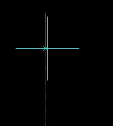

haha my problem is that it is off at the moment. the pic i posted previously was from the old cad i used to use.
i want it on and don't know how..
this pic is from the new cad i'm using which doesn't show it

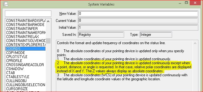

Sounds like COORDS, see the screenshot from my SYSVDLG in 2013.

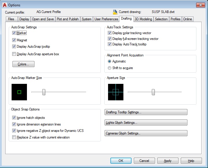

You will want to turn on Polar Tracking, in order to get it to display like that.

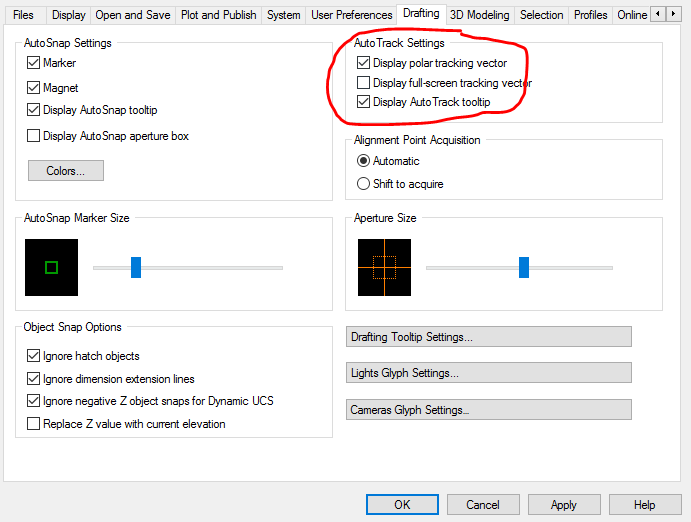

Sounds like but it is not. COORDS are found in the status bar. It is definitely Auto Track Settings. Tested and verified.
Hey Rob, I stand corrected, you were right. :beer:
It just so happens the settings you suggested, are my standard ones.
Which is why when I was tweaking the COORDS system variable, and attributing what I saw to that variable, I erroneously took it to be the cause.

i still can't get it to show up.. i've tried all manner of combinations for the autotrack settings :(
just worked it out.. seems to be due to the colours!!
i use black background and looks like my tooltip was also set black so it disappeared. altho now when i change it back to black there is a background/mask type thing so i can see it anyway so i dunno what was going on before..
either way its working now. :) cheers for the help guys
Glad you were able to figure it out.
You might want to set your tooltip color to 7, instead of black.
