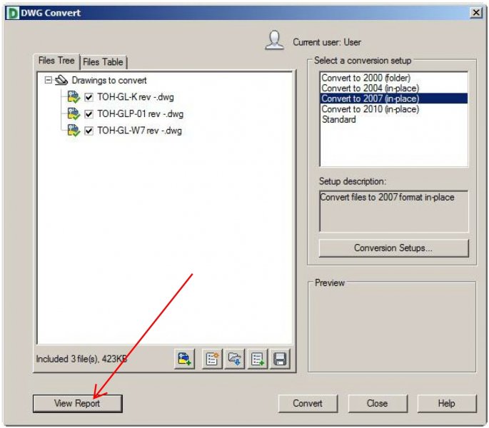

Manila Wolf Posted October 8, 2016 Posted October 8, 2016 If you converted your drawings using the default "Standard" conversion set up, it may have created a zip file and placed it in your "My Documents" folder. As RobDraw suggested, check your conversion setup settings. The desired location folder for converted drawings can be set there. If you use a conversion setup using the (in Place) option, it will place the converted drawings in the same folder as the source drawings. The source drawings will still be there but will be renamed with a .Bak extension. Quote

Manila Wolf Posted October 10, 2016 Posted October 10, 2016 (edited) The conversion was to be in place. I assume that the converted drawing was to be in the same folder It is indeed something of a mystery. Have you tried searching your hard drive for the drawing? I guess the drawings are not read only, as Dwg Trueview would flag it. Maybe if you look at the conversion report it may tell you something. See attached image showing which button to press to see the conversion report. Edited October 10, 2016 by Manila Wolf Spelling Quote

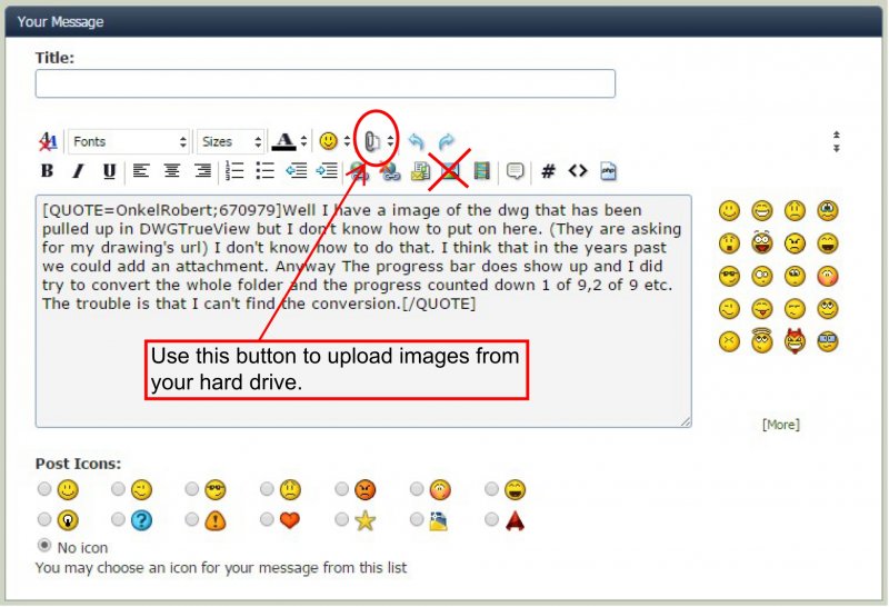

Manila Wolf Posted October 10, 2016 Posted October 10, 2016 Well I have a image of the dwg that has been pulled up in DWGTrueView but I don't know how to put on here. (They are asking for my drawing's url) I don't know how to do that. I think that in the years past we could add an attachment. Anyway The progress bar does show up and I did try to convert the whole folder and the progress counted down 1 of 9,2 of 9 etc. The trouble is that I can't find the conversion. If you want to upload from your hard drive, use the "Attachments" toolbutton in lieu of the "Insert Image" toolbutton. Quote
RobDraw Posted October 10, 2016 Posted October 10, 2016 The conversion was to be in place. I assume that the converted drawing was to be in the same folder Just to make sure you are clear. The in place option overwrites the source file. Quote
