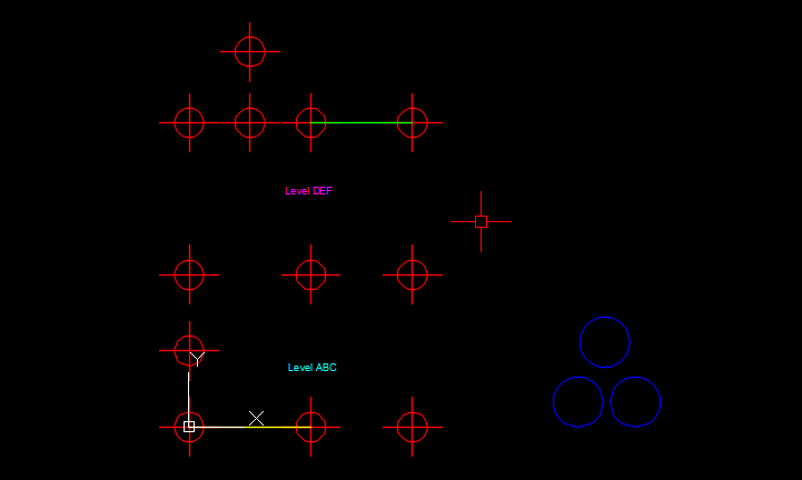

I need mirror of selected objects with reference to X-X axis. in my sample drawing i have selected all objects excluding blue circles. "please find after mirror drawing" and kindly share suitable lisp.

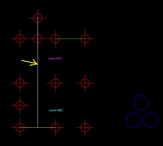

I drew one line (see yellow arrow) and mirrored based on its midpoint.
Lisp doesn't necessarily have to be the answer to all of our problems. Maybe we're just getting lazy?
There is no need for temporary geometry if you use MTP.
Yes, you are correct. Can't get much simpler than that.

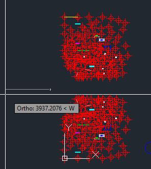

thank you for yours kind replies.in my original drawing contains many objects like points, lines, blocks, text etc.i have facing difficulty to draw line for mirroring. because all items are irregular intervals. i am confusing minimum and maximum coo ordinates to draw line (because minor differences between points to point, and points are very closer and overlaping). so if any possibility by lisp kindly share.

selecting by cross window, and mirroring as mention procedure at Post#3 & #4 ( Mid point of selected objects with reference to y coordinates). full drawing is bit confusing. that's why i have posted simple drawing. Post #3 & #4 are exact procedure by manually draw line and applied mirror. i need lisp version for the same, to apply for large content drawing like a Quick mirror lisp.

here i am attached one sample full drawing. please find and help me by suitable lisp program.

If the co-ordinates of the project are not relevant then just grab all the objects and pick an approx center keep ortho on and mirror. Do the blue circles have some sort of relevance to the rest of the objects ? Like Remark it seems to me that were being asked for something so simple that does not need a lisp.
