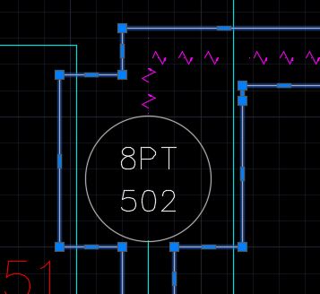

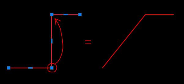

bustr Posted October 3, 2016 Posted October 3, 2016 I have tried stretch some of the corners of a polyline to create diagonal sides. Autocad is not letting me do this. What setting needs to be changed to allow autocad to function normally? Quote
bustr Posted October 3, 2016 Author Posted October 3, 2016 Nope! Has no effect. I grab one of the corner grips and pull it and the whole side comes with it. Quote
ReMark Posted October 3, 2016 Posted October 3, 2016 I think you picked the wrong grip. Works fine for me. Quote
bustr Posted October 3, 2016 Author Posted October 3, 2016 It doesn't matter which grip I pick. I can pick a mid-point or corner. The whole vertical or horizontal segment comes with it. The pline segments are locked into the horizontal and vertical axes. If I grabbed it like you did it would stretch the whole bottom horizontal segment up and create a single horizontal line. Quote
ReMark Posted October 3, 2016 Posted October 3, 2016 What happens if you start a new drawing and try the same thing? Quote
RobDraw Posted October 3, 2016 Posted October 3, 2016 You may have unchecked infer constraints. You still need to remove them from existing objects. https://knowledge.autodesk.com/support/autocad/troubleshooting/caas/sfdcarticles/sfdcarticles/How-to-turn-off-and-delete-constraints-in-AutoCAD.html Quote
