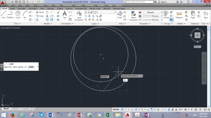

khoshravan Posted October 2, 2016 Author Posted October 2, 2016 (edited) I have 2 objects, let say two circles with different centers and different radius. I want to draw a line from quadrant of one circle with 50 degree angle until it intersects with other circle. Obviously the length of the line is unknown. A basic solution would be to draw a longer line and then trim it. But I want to be more productive and draw in one step. Is it possible? Edited October 2, 2016 by khoshravan Quote

Dana W Posted October 2, 2016 Posted October 2, 2016 You can't know the intersecting point ahead of time, and there are no random snaps on a circle. You have only quadrant, tangent, perpendicular, and center. Since your line will only hit one of these points by chance, depending on the alignment of the two circles, your longer line drawn at the proper angle, then trim is about it. At least it's accurate. Quote
BIGAL Posted October 2, 2016 Posted October 2, 2016 You have Autocad so maybe a good time to learn lisp it can be done, quad, angle, pick 2nd circle, draw line done, hint "intersectwith". At 458 posts you should be starting to have a go rather than just rely on every one else. Quote

khoshravan Posted October 3, 2016 Author Posted October 3, 2016 Dear Dana and Bigal Thanks for your replies. Someday I will go for LISP. Now it is too early for me. So the method I applied already, seams to be the best solution. Quote
