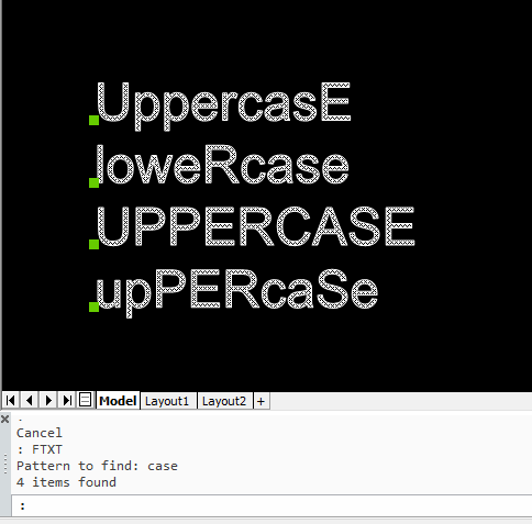

mhupp Posted June 26, 2022 Posted June 26, 2022 This will find any text or mtext that contains what you input regardless of capitalization and then select/highlight it. ;;----------------------------------------------------------------------------;; ;; Find and Select Text (defun C:FTXT (/ str SS) (setq str (strcat "*" (getstring "\nPattern to find: ") "*")) (if (setq SS (ssget "_X" (list (cons 0 "*TEXT") (cons 1 str) (cons 410 (getvar 'ctab))))) (prompt (strcat (itoa (sslength ss)) " items found")) ) (sssetfirst nil SS) (princ) ) Quote

BIGAL Posted June 26, 2022 Posted June 26, 2022 Hmmm ok for me (sslength (ssget "_X" (list (cons 0 "*TEXT") (cons 1 "*case*") (cons 410 (getvar 'ctab))))) 5 Quote

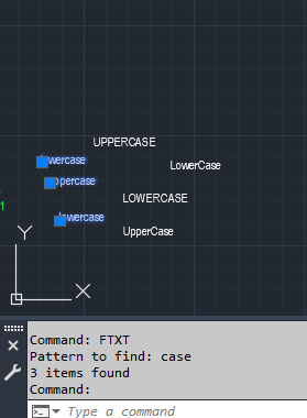

Steven P Posted June 27, 2022 Posted June 27, 2022 Just had a quick check, didn't work here either, and was case sensitive 1 Quote

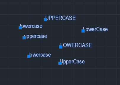

mhupp Posted June 27, 2022 Posted June 27, 2022 (edited) Looks like BricsCAD searches text without case sensitivity or it might be a variable BIGAL and myself have turned on IDK. This will convert everything to uppercase with strcase (for matching with wcmatch) so case sensitivity doesn't matter. ;;----------------------------------------------------------------------------;; ;; Find and Select Text (defun C:FTXT (/ ss ss1 str) (setq ss1 (ssadd)) (setq str (strcat "*" (strcase (getstring "\nPattern to find: ")) "*")) (if (setq ss (ssget "_X" (list '(0 . "*TEXT") (cons 410 (getvar 'ctab))))) (foreach ent (vl-remove-if 'listp (mapcar 'cadr (ssnamex ss))) (setq obj (vlax-ename->vla-object ent)) (if (wcmatch (strcase (vla-get-TextString obj)) str) (setq ss1 (ssadd ent ss1)) ) ) ) (prompt (strcat (itoa (sslength ss1)) " items found")) (sssetfirst nil ss1) (princ) ) Edited June 27, 2022 by mhupp Code Updated 1 Quote
jr.roberto.santos Posted June 27, 2022 Posted June 27, 2022 @mhupp Perfect, I just changed the variable ss to ss1 (sssetfirst nil ss1) Best regards 1 Quote
