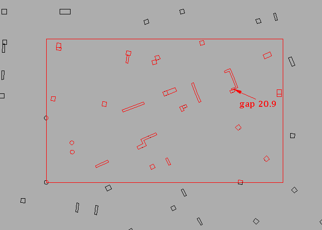

cadsterdyne Posted September 26, 2016 Posted September 26, 2016 Hi Forum. Great tool this boundary command, but is there a way to increase precision as in attached drawing i observed that when i zoom out till all the objects are visible and pick a point somewhere for the boundary command there are a few places where the boundary formed is merging the two objects in one boundary as there is a minute gap there. is there way to increase the boundary command precision? Thank you in advance. BOUNDARYPRECISSION.dwg Quote

eldon Posted September 26, 2016 Posted September 26, 2016 i have a feeling (and someone can state otherwise) that the boundary command depends on the screen resolution. It cannot resolve less than a pixel or a bit less. That is why your boundaries are not matching your shapes. If you zoom in, the boundary command works perfectly. I do not think that there is any system variable which will enhance your actual screen resolution. Quote

cadsterdyne Posted September 26, 2016 Author Posted September 26, 2016 i have a feeling (and someone can state otherwise) that the boundary command depends on the screen resolution. It cannot resolve less than a pixel or a bit less. That is why your boundaries are not matching your shapes. If you zoom in, the boundary command works perfectly. I do not think that there is any system variable which will enhance your actual screen resolution. You are right eldon. i have tried zooming in and creating boundaries and it works flawlessly. the problem is when i get all objects in view and try creating the boundaries, i tried setting limits for the drawing very close to the extent of all the objects , No luck, searched the internet a bit found HPGAPTOL variable could be adjusted but it is already set to zero. no help there. Quote

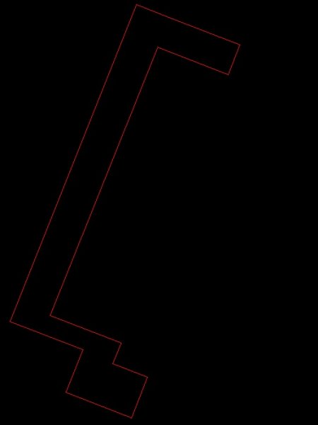

marko_ribar Posted September 26, 2016 Posted September 26, 2016 Since you are using 2D Wireframe as the Visual style I think the problem lies with the 2D display list that is used and not the screen resolution. Try the following: 1. Open the drawing and do a zoom extents. 2. Zoom in on the drawing with z [enter] 10x [enter] 3. Give the regen command to rebuild the display list at a higher precision. 4. Zoom out with the scroll wheel and try the boundary selection. ~Lee @Lee No that's not it... I've just tried ZOOM "Center" pick point in center of right portion - type factor : 200 => REGEN => ZOOM "V" to zoom out maximum - should display all right portion => BPOLY pick internal point - incorrect number of POLYLINES are created and you can see that narrow passages between them are jumped over and bigger single boundary is created when zoomed to corresponding "red" examples entities from left portion and it should create 2 separate smaller boundaries... Quote
lrm Posted September 26, 2016 Posted September 26, 2016 @LeeNo that's not it... I've just tried ZOOM "Center" pick point in center of right portion - type factor : 200 => REGEN => ZOOM "V" to zoom out maximum - should display all right portion => BPOLY pick internal point - incorrect number of POLYLINES are created and you can see that narrow passages between them are jumped over and bigger single boundary is created when zoomed to corresponding "red" examples entities from left portion and it should create 2 separate smaller boundaries... Regen does affect the precision of the boundary pick. After your Zoom View the geometry is fairly small and difficult to get a screen pick inside one of the problem shapes (Note, Zoom V does not recalculate the display list whereas zoom e does, so you are OK using Zoom V). When I do pick inside the shape after the zoom v the boundary is successfully created. I did the same process using zoom e and did create a boundary that did merge shapes proving that regen does affect precision. ~Lee Quote
eldon Posted September 27, 2016 Posted September 27, 2016 .....When I do pick inside the shape...... I think that the OP was trying to save having to pick 420 times by having one rectangle surrounding all the shapes, and then picking once, inside the large rectangle. Quote
cadsterdyne Posted September 27, 2016 Author Posted September 27, 2016 I think that the OP was trying to save having to pick 420 times by having one rectangle surrounding all the shapes, and then picking once, inside the large rectangle. Very Right eldon. if the bpoly command is so much to do with the resolution..then would higher resolutions on a 4k monitor with a good graphics card make it work would not go buying a 4k monitor for this though. Quote

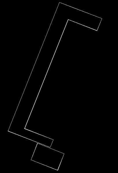

eldon Posted September 27, 2016 Posted September 27, 2016 Pursuing my hypothesis that the minimum gap detection is linked to the display pixels, I carried out a little quantitative test. First of all I tried to find the minimum gap in the posted drawing. I found one gap of 20.9 drawing units. I then found out my screen size in pixels (x,y) from the command SCREENSIZE. I then multiplied these by 40 (to give the sense that the gap was half a pixel), and drew a rectangle of these dimensions. I zoomed to the window given by the rectangle. Bpoly found all the gaps in that area. It worked for me. Quote
marko_ribar Posted September 27, 2016 Posted September 27, 2016 Conclusion : Minimal gap that can be detected by BPOLY is more than 1 pixel of current display zoomed area... But like I said in post #4, sometimes REGION command is the right way to accomplish such tasks... Quote
eldon Posted September 27, 2016 Posted September 27, 2016 Conclusion : Minimal gap that can be detected by BPOLY is more than 1 pixel of current display zoomed area... My findings were that the minimum gap detected was half a pixel. But someone may the know the definitive answer. Quote
