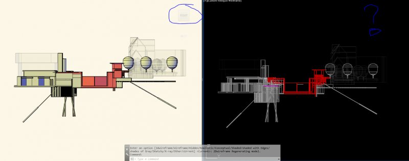

Some hate it, ..some use it. The viewcube. I do find it easy handy to use especially in combination with a named ucs. The problem now i have (only recently?) is that is only works in 3d displaystyle, conceptual. I want this to show in 2d as well, and i think i once had this going..
What cubedisplay setting do i miss here?
Thanks
Hans
Options, 3D Modeling tab, look along the left side for the selections you are needing.
Very strange. It will not display in 2D wireframe.
But i seem to have more graphics problems.
Text is not visible with 3Dconfig - hardware accelaration turned ON.
maybe something with Direct X11?
So... i did a full reset of AutoCAD installations !
But navvcubedisplay =3 still does work
Strange..
