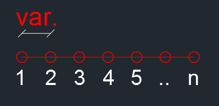

MastroLube Posted September 19, 2016 Posted September 19, 2016 Hi everyone, hope this is the right section.. I want to create a special dynamic block with two dynamic parameters. I need it to improve speed of drawing punch reinforcement. This is how it looks like: So the distance of circle is variable and even the number of them. Is it possible to create it? Can you give me an advice? Quote

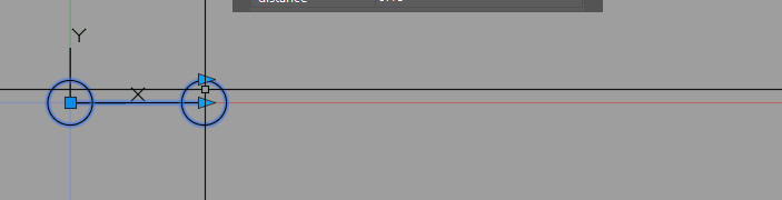

MastroLube Posted September 20, 2016 Author Posted September 20, 2016 It might be helpful to post on actual .dwg. ok, this is the block I've created.. punz.dwg It's very simple but you can see the problem.. I'm not able to link distance between circle to arrays. The array generate the next circle at the distance I draw in the block. The goal is to have the distance between all the circle always the same. Any advice? Quote
steven-g Posted September 20, 2016 Posted September 20, 2016 Unfortunately variable arrays are not an option in dynamic blocks, If you have a limited number that you need to achieve then a stretch action and a number of visibility states may help you, but after about 10 items it starts to get long winded. Quote
BIGAL Posted September 21, 2016 Posted September 21, 2016 Have a look at this sample drawing from civ3d it uses fixed spacing but drag for more car parks. You should be able to just repeat the circle not use an array. Parking Tools - Metric.dwg Quote
steven-g Posted September 21, 2016 Posted September 21, 2016 I had something like this in mind! @BIGAL there are some nice blocks in there Array.dwg Quote
