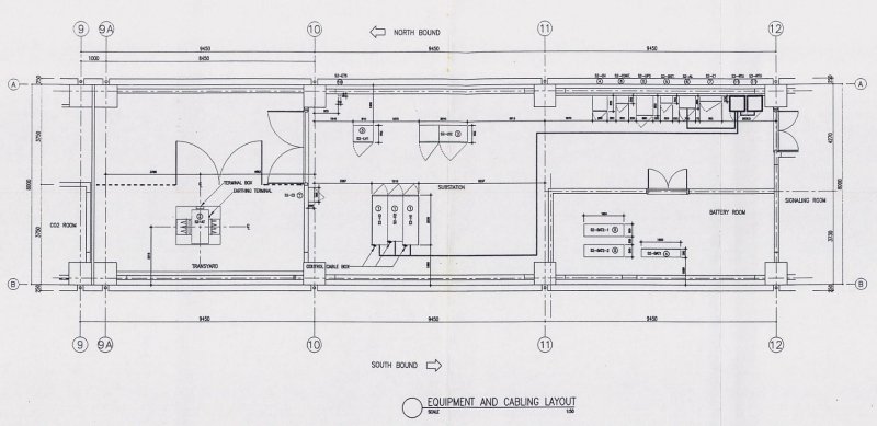

Hi Guys,
Converting PDF to DWG may not be possible..because the image is scanned and did not really came from the dwg file...the drawing is made 10 years ago and the client no longer has the dwg file..I think I might just draw it from scratch but I might need some of your help since it will be my first time to recreate a floor plan...I do electrical schematics most of the time and some architectural details may not be very familiar to me I hope you can help me identify some stuff....here is the image of the floor plan I will draw
can you help me identify the
-wall thickness
-size of big doors
-size of small doors
-foundation (square ones)
Hope you guys can help me on this one..Thanks
After inserting the pdf rescale it as close as practical you have some dimensions to work to scale 0.987258 then like others re-draw it with known measurements, you should be able to work out the door sizes, looks metric.

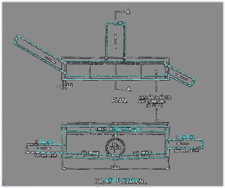

Something I am working on but with true measurements.

And don't waste your time with PDF to DWG conversion on a raster PDF.
Why is that? I didn't even know you could do that, haha. Guess I need to do a google to find more about it. Although, why do you say not to waste your time using it?
It really depends on what you plan to do with the conversion. If you expect anything resembling a usable AutoCAD drawing, forget it. If all you need is a bunch of garbage on layer zero for use as a background or something similar and don't plan on making any edits to the content, it might be feasible.
You have dimensions on the pdf to work with so I would xref this into the drawing, scale it as close as you can get it using one of those drawings. Use this as a guide in the drawing, drawing on top of the pdf but use the dimensions given don't just trace point to point. Take a measurement of a door opening, does it measure 900 or 908. If a standard metric size door is 900 then you know how wide to actually draw it. Same for the columns and anything else not dimensioned. Once you have most of what you need then detach the pdf and finish cleaning it up. Really pretty simple stuff, just tedious. And if you are off on the sizes of wall thickness, etc. you can't be blamed if there are no dimensions. Just use even numbers for things you don't have dimensioned on the drawing.
That is almost exactly what I would have done rkent. Hopefully the OPer will check it out. Whenever we have PDF that we need digitized I always just bring into model space and align the largest dim or bar scale I have. Then digitize but, like you stated using the actual dim not only tracing.
