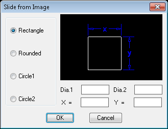

drafter_joe Posted September 12, 2016 Posted September 12, 2016 Hello! I have a dialog box routine and I need help with the spacing of the items I have in it so that it would look nice and professional. It doesn't do anything yet, I'd like to get the spacing figured out first, seems like the more difficult part so far. I have attached a zip file that contains all the codes and image files, in case they are necessary, and an image of what the dialog box looks like currently. Thank you for your time and attention, it is much appreciated! Drafter_Joe SlideImage.zip Quote
Roy_043 Posted September 12, 2016 Posted September 12, 2016 Every tile in a DCL dialog requires a certain amount of space. Tiles with longer labels require more horizontal space. On average the tiles in the top row of your dialog are wider making it the row that determines the total width of the dialog. In the bottom row there is horizontal room to spare and this is used to space the tiles further apart. The only way to create proper vertical alignment is to supply both the width and the fixed_width attributes for most tiles and to base the width of each tile on the tile of the same type with the longest label. Keep in mind that a margin is added to the right of each label. This margin is ca. 30% of the width of the text. Choose short labels to avoid large margins. Try to use more descriptive keys. Something like "eb5" is not very clear, "circInCircDia1" is. I personally would get rid of the radio_buttons and turn the images into image_buttons instead. Or I would use 'radios' without labels. Quote
rlx Posted September 13, 2016 Posted September 13, 2016 how about : (defun c:tst ( / box_type dcl-id) (setq box_type "rectangle" dcl-id (load_dialog "SlideImage.DCL")) (new_dialog "Main_Dialog" dcl-id)(update_dialog) (action_tile "rb_rectangle" "(setq box_type \"rectangle\")(update_Dialog)") (action_tile "rb_rounded" "(setq box_type \"rounded\")(update_Dialog)") (action_tile "rb_circle1" "(setq box_type \"circle1\")(update_Dialog)") (action_tile "rb_circle2" "(setq box_type \"circle2\")(update_Dialog)") (action_tile "accept" "(done_dialog 1)") (action_tile "accept" "(done_dialog 0)") (start_dialog) (unload_dialog dcl-id) (princ) ) (defun update_dialog ( / x y slide) (cond ((= box_type "rectangle")(setq slide (findfile "test1.sld"))(set_tile "rb_rectangle" "1")) ((= box_type "rounded") (setq slide (findfile "test2.sld"))(set_tile "rb_rounded" "1")) ((= box_type "circle1") (setq slide (findfile "test3.sld"))(set_tile "rb_circle1" "1")) ((= box_type "circle2") (setq slide (findfile "test4.sld"))(set_tile "rb_circle2" "1"))) (setq x (dimx_tile "im_box_type") y (dimy_tile "im_box_type")) (start_image "im_box_type") (fill_image 0 0 x y -2);wipe (slide_image 0 -20 x y slide) (end_image) ) Main_Dialog : dialog { label = "Slide from Image"; : row { : boxed_radio_column { : radio_button { key = "rb_rectangle"; label = "Rectangle";} : radio_button { key = "rb_rounded"; label = "Rounded";} : radio_button { key = "rb_circle1"; label = "Circle1";} : radio_button { key = "rb_circle2"; label = "Circle2";}} : column { : image { key = "im_box_type"; width = 14; height = 10; color = -2;} : row { : edit_box { key = "eb_dia1"; label = "Dia.1";} : edit_box { key = "eb_dia2"; label = "Dia.2";}} : row { : edit_box { key = "eb_x"; label = " X = ";} : edit_box { key = "eb_y"; label = " Y = ";}} } } spacer; ok_cancel; } gr. Rlx Quote
Roy_043 Posted September 13, 2016 Posted September 13, 2016 @ Rlx: You are using spaces in the labels in an attempt to align edit_boxes. As you can see for yourself the vertical alignment is not perfect (and may vary depending on the font used for the labels). As explained in my previous post, setting both the width and the fixed_width attributes is the way to solve this. Quote
rlx Posted September 13, 2016 Posted September 13, 2016 (edited) @ Rlx:You are using spaces in the labels in an attempt to align edit_boxes. As you can see for yourself the vertical alignment is not perfect (and may vary depending on the font used for the labels). As explained in my previous post, setting both the width and the fixed_width attributes is the way to solve this. jip , I am aware of that , but because it is a very short label it's no big deal. To get it perfect you can create a row with 4 columns , first column for dia1 & X , second for the two editboxes , third for dia2 & Y and the last for the other edit boxes. Normally I would do it this way but the labels are so short , in this case , the effect is minimal. But for the fans : Main_Dialog : dialog { label = "Slide from Image"; : row { : boxed_radio_column { : radio_button { key = "rb_rectangle"; label = "Rectangle";} : radio_button { key = "rb_rounded"; label = "Rounded";} : radio_button { key = "rb_circle1"; label = "Circle1";} : radio_button { key = "rb_circle2"; label = "Circle2";}} : column { : image { key = "im_box_type"; width = 14; height = 10; color = -2;} : row { : column { : text { label = "X";} : text { label = "Y";}} : column { : edit_box { key = "eb_x"; } : edit_box { key = "eb_y";}} : column { : text { label = "Dia.1";} : text { label = "Dia.2";}} : column { : edit_box { key = "eb_dia1"; } : edit_box { key = "eb_dia2";}} } } } spacer; ok_cancel; } There are some disadvantages using fixed width and height , for instance when you want to resize your image , the size for your edit box will remain the same. Use colums and your design will stretch with it... but that's up 2U... gr. Rlx Edited September 13, 2016 by rlx Quote
drafter_joe Posted September 13, 2016 Author Posted September 13, 2016 Hey Guys! @Roy_043: Thank you, Roy_043 for your advice! I would be making changes to names and such before I was done, more descriptive is definitely a better way to go. My original thought was to have the images be clickable, what I found on that seemed a little complicated to me. I will work at this and where it goes. @rlx: Thank you, rlx for your code! What you have is certainly far more streamlined. I like what I see here, nice and tidy. I haven't had a chance to test out your code yet, but I will for sure soon. Thanks to you both, and others like you, on these forums helping those of us who know there's a better way but were just not very sure of how to go about it! Cheers! Quote

Lee Mac Posted September 13, 2016 Posted September 13, 2016 Attached is my take on the program: personally, I like any dialog images to appear embedded as part of the interface, and the use of a slide library reduces the number of files which need to be distributed. AutoLISP Code: (defun c:test ( / dch ) (cond ( (<= (setq dch (load_dialog "test.dcl")) 0) (princ "\nUnable to find/load test.dcl file.") ) ( (not (new_dialog "test" dch)) (princ "\nUnable to display dialog.") ) ( (set_tile "dcl" "Slide Library Example") (foreach key '("sl1""sl2""sl3""sl4") (action_tile key "(updatetiles $key)") ) (set_tile "sl1" "1") (updatetiles "sl1") (start_dialog) ) ) (if (< 0 dch) (unload_dialog dch)) (princ) ) (defun updatetiles ( key ) ( (lambda ( x y ) (start_image "sld") (fill_image 0 0 x y -15) (slide_image 0 0 x y (strcat "test(" key ")")) (end_image) (mapcar 'mode_tile '("ed1""ed2""ed3""ed4""ed5") (cadr (assoc key '( ("sl1" (0 0 1 1 1)) ("sl2" (0 0 0 1 1)) ("sl3" (1 1 1 0 1)) ("sl4" (1 1 1 0 0)) ) ) ) ) ) (dimx_tile "sld") (dimy_tile "sld") ) ) DCL Code (to be saved as test.dcl): edit : edit_box { edit_width = 12; width = 20; fixed_width = true; } test : dialog { key = "dcl"; spacer; : row { spacer; : radio_column { fixed_height = true; : radio_button { label = "Rectangle"; key = "sl1"; } : radio_button { label = "Rounded"; key = "sl2"; } : radio_button { label = "Circle"; key = "sl3"; } : radio_button { label = "Pipe"; key = "sl4"; } } : image { key = "sld"; width = 33.5; fixed_width = true; aspect_ratio = 0.66; } : column { fixed_height = true; : edit { label = "X:"; key = "ed1"; } : edit { label = "Y:"; key = "ed2"; } : edit { label = "R:"; key = "ed3"; } : edit { label = "D1:"; key = "ed4"; } : edit { label = "D2:"; key = "ed5"; } } spacer; } spacer_1; ok_cancel; } The above files along with the Slide Library file are attached. test.zip 1 Quote

drafter_joe Posted September 14, 2016 Author Posted September 14, 2016 Attached is my take on the program: personally, I like any dialog images to appear embedded as part of the interface, and the use of a slide library reduces the number of files which need to be distributed. [ATTACH]59250[/ATTACH] Lee, By chance could you incorporate my drawing below, but done by your standards as seen in your previous attachment, as the 5th choice, please? I can see how to add the two extra edit boxes, but to attempt the slide like the ones you've done already, would frustrate me terribly. That's not even considering the slide library, very new to me. Thank you! Drafter_Joe Quote
Lee Mac Posted September 14, 2016 Posted September 14, 2016 fragile beauty,Thank you, and learning. Thank you for your kind words! test.slb Can package vlx? To my knowledge, unfortunately not. Looks great Lee! (the mode_tile part) Cheers! Thank you Lee! It looks great! You even went the next step, making only the necessary edit boxes available with the corresponding choice. This is where I was headed next. I will enjoy learning how your code works. I have another slide to add and a couple of more edit boxes. Bravo, old chap! Cheers! Thanks Joe! - Feel free to ask if you have any questions about the code. By chance could you incorporate my drawing below, but done by your standards as seen in your previous attachment, as the 5th choice, please? I can see how to add the two extra edit boxes, but to attempt the slide like the ones you've done already, would frustrate me terribly. That's not even considering the slide library, very new to me. Sure - please try the attached. Lee test.zip Quote
