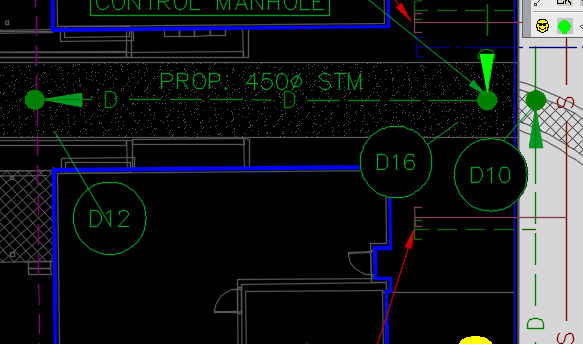

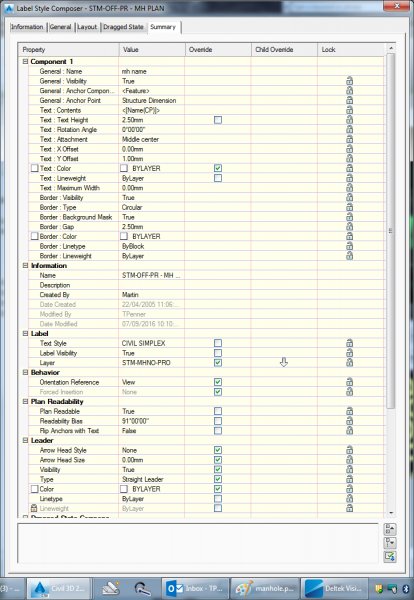

Silvercloak Posted September 7, 2016 Share Posted September 7, 2016 I'm losing my mind over here. For months I've been using horrible drafting techniques (yes I've even exploded at times) to get around this and I'm hating it. HATING it... I need to fix this permanently once and for all. Can anyone tell me how to get the leader to actually TOUCH the frigging manhole? I can't seem to find anything in my style settings... Screen caps to follow... If anyone has any idea.... Silvercloak Quote Link to comment Share on other sites More sharing options...
BIGAL Posted September 8, 2016 Share Posted September 8, 2016 Just a stab in the dark, Leader, Arrow head style, small dot, Arrow size say 0.01, I have not passed the Degree in "Styles" yet, after all there are only 152 questions. Quote Link to comment Share on other sites More sharing options...
Silvercloak Posted September 9, 2016 Author Share Posted September 9, 2016 We can work through all 152 if it solves this. Tried those - but it hasn't fixed it... Incidentally it seems to only be a big problem when the viewport is rotated. Which is asnine since seriously - how hard is it to anchor the frigging leader to the center of the structure? That's ALL i ask. Quote Link to comment Share on other sites More sharing options...
Silvercloak Posted September 9, 2016 Author Share Posted September 9, 2016 Sometimes it works if I only label the Xref and NOT the data reference... no idea why. Quote Link to comment Share on other sites More sharing options...

Silvercloak Posted October 6, 2016 Author Share Posted October 6, 2016 Silvercloak, Could you possibly post a .dwg of this so I can play around with it? Well I've run across the problem again. I tried to prepare the drawing for transmittal, but as soon as I promoted the datalinks - BOOM the manholes connected. Which is quite an impractical solution since the entire purpose of data shortcuts is NOT to have everything repeated in each drawing but rather referenced.... I have no idea why it being a data shortcut should make a difference. Oh and if I XREF it, it usually fixes it. But if I Xref AND Data Shortcut the pipe network in the same drawing, there's a good chance it'll bork the profiles. (this is another autoCAD glitch I've run across) so it's always either or. And I DETEST having profiles xrefed into a drawing. Silvercloak Quote Link to comment Share on other sites More sharing options...
