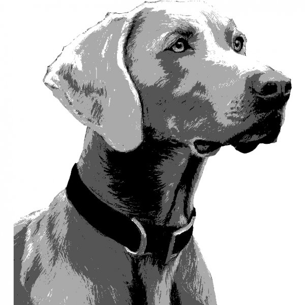

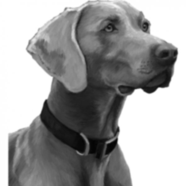

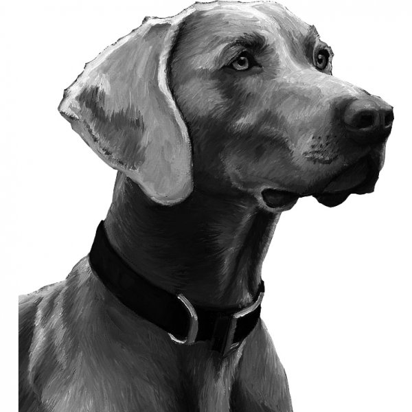

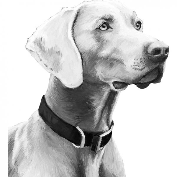

Do you think the images below will give a good result, I'm trying to play around with ZBrush at the moment......? I wasn't quite sure what to do about the white BG?
The white background is going to be a problem because when you convert the image to an alpha and then Mask by Alpha, the white area will be fully unmasked. So when you try to offset the surface or sculpt, you will be affecting the white background more than the image of the dog. You should change the background to black.
You may also have to lighten the dogs collar to more of a grey color. Anything that's black will be fully masked.
