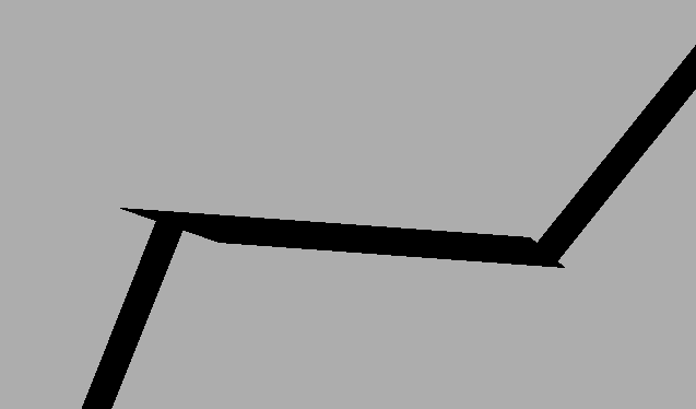

sivapathasunderam Posted August 29, 2016 Share Posted August 29, 2016 Dear anyone; At the movement I could not remember why this happens... Polyline Geometry Start segment 0.500 End segment 0.500 Global width 0.500 thanks Siva Quote Link to comment Share on other sites More sharing options...
Draw n'go Posted August 29, 2016 Share Posted August 29, 2016 are the two lines the same width? I'm thinking if you type in (fillet, radius, 0) that might fix it Quote Link to comment Share on other sites More sharing options...
sivapathasunderam Posted August 30, 2016 Author Share Posted August 30, 2016 are the two lines the same width? I'm thinking if you type in (fillet' date=' radius, 0) that might fix it[/quote'] thanks very much for your quick response. Both polyline width are the same 0.500 & I have try (fillet, radius, 0) also no change then I have try to attach the cad file with only the part postion of Polyline, file size became approx. 5MB Thanks in advance for any help/advice Siva Quote Link to comment Share on other sites More sharing options...
MillerMG Posted August 30, 2016 Share Posted August 30, 2016 Have you looked at the Misc. Properties under linetype generation? If you have them joined this may fix your issue. Side question: Are they joined? Do the both have zero for elevation (or same elevation, whichever) Quote Link to comment Share on other sites More sharing options...
SAFeSTeR Posted September 2, 2016 Share Posted September 2, 2016 I've seen this problem in my drawings and found it to be 2 or more vertices in very close proximity to one another. I was able to replicate this effect in a matter of seconds just now and when I measured the distance between the 2 points it was less than 0.000 units, just to give you an idea of how close they may be. However, the rectangular middle grip was visible at the join point and it isn't in yours, so maybe it's another issue entirely. If the line isn't made up too many points, select it and in the properties window under 'Geometry' click in the 'Current Vertex' area then use the arrows to cycle through each vertex, you may find 2 in one place. Alternatively, zoom in closely after selecting the line. You could try breaking the line a small length from the point in both directions and reextending / joining to see if the problem persists. Quote Link to comment Share on other sites More sharing options...

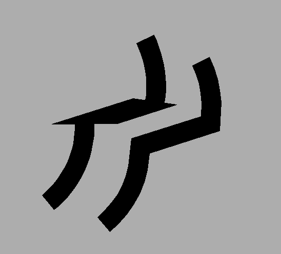

eldon Posted September 5, 2016 Share Posted September 5, 2016 I was able to reproduce the anomaly, and I would think that it is a bug in AutoCAD. I formed a polyline by joining an arc with a straight line with an arc, and the programme does not seem to be able to cope with certain angle differences between the elements when the polyline is given a width, and lead to the odd junction at times. If it is important to have a wide line, I suggest that you try line-weights to give the effect. Quote Link to comment Share on other sites More sharing options...

eldon Posted September 6, 2016 Share Posted September 6, 2016 A thought struck me that the problem occurs when the line next to the arc is not nearly tangential to the arc. So if one inserts a short section of straight line after the arc before joining up with the line that is at approximately right angles to it, the visual junctions should be much improved. Have a play, but I don't think there is an automatic way of doing this (yet). Quote Link to comment Share on other sites More sharing options...
MillerMG Posted September 6, 2016 Share Posted September 6, 2016 Nice job Eldon!!! That is very strange, I am surprised that this isn't fixed in autocad. Guess its not very common to have global width on arcs like that? Quote Link to comment Share on other sites More sharing options...
