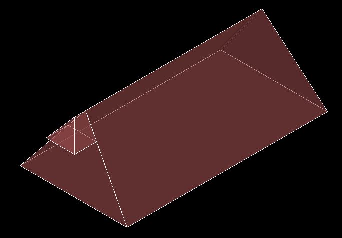

tom111 Posted August 18, 2016 Author Share Posted August 18, 2016 (edited) I cannot advise you one way or the other as to whether or not the Roof Tools in ACA can help you with your problem. I do not use the program. How long can you wait to see if someone familiar with the program provides you with an answer? I could probably come up with a way to rough out the design using plain AutoCAD's 3D modeling commands. Is this close? [ATTACH]59020[/ATTACH] Sorry but I have to go out into the plant for a couple of hours. The fabrication shop is installing one of my projects. I'll check back later. In the meantime maybe another forum member can offer up some advice. Good luck. That's it nearly. The dimension between the two arrows should be zero though if that's okay Edited August 18, 2016 by tom111 Subsequent reflection Quote Link to comment Share on other sites More sharing options...

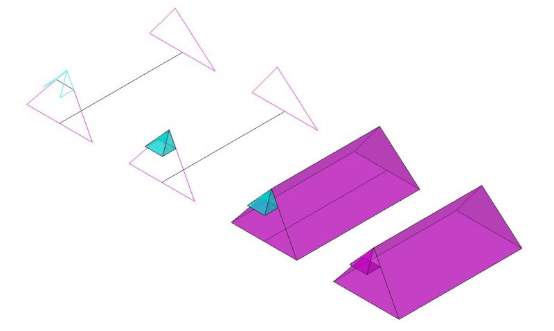

ReMark Posted August 18, 2016 Share Posted August 18, 2016 Is this what you had in mind? Mainly constructed using the LOFT and SLICE (w/Surface option) commands. OK. Off to home, dinner and a beer! Will check this thread first thing Friday morning. Quote Link to comment Share on other sites More sharing options...
ReMark Posted August 19, 2016 Share Posted August 19, 2016 After having my usual ten cups of coffee and looking at this again with fresh eyes I think the 3D model of the roof could be constructed using just the LOFT command. Once I have ACAD up and running I might give it a try. Quote Link to comment Share on other sites More sharing options...

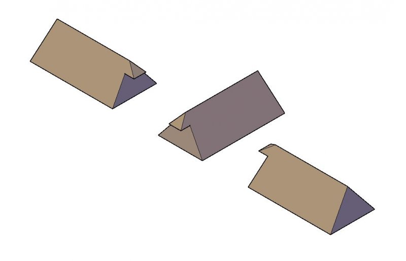

danellis Posted August 19, 2016 Share Posted August 19, 2016 If you're still looking for an ACA-based solution, I'd do it by producing two roofs - one for the main building and a second for the bay window. dJE Quote Link to comment Share on other sites More sharing options...
ReMark Posted August 19, 2016 Share Posted August 19, 2016 Got that chance to try it again. Lofting a couple of similar triangles then joining them with the union command does work. Quote Link to comment Share on other sites More sharing options...

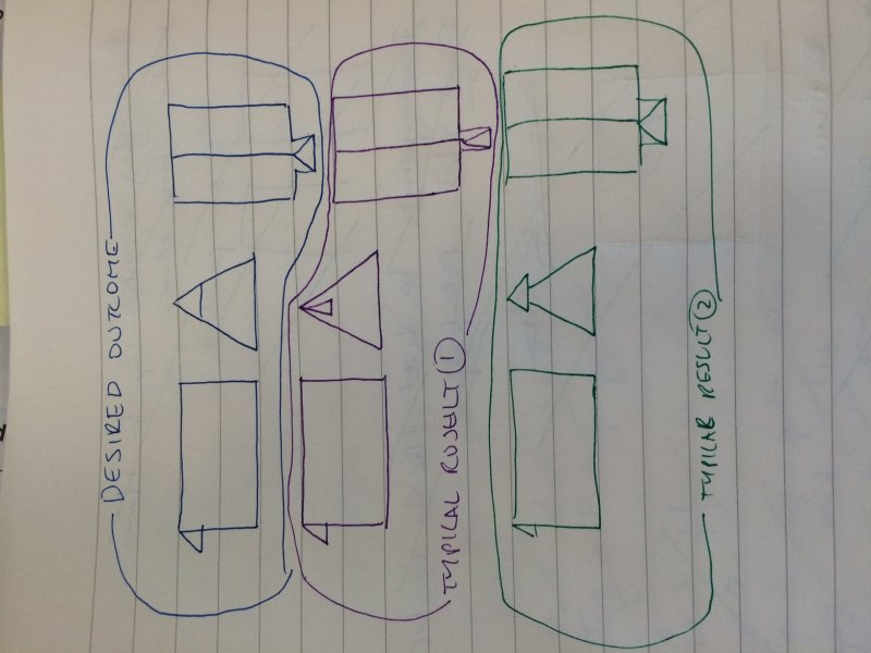

tom111 Posted August 22, 2016 Author Share Posted August 22, 2016 Thanks ReMark, would you perhaps be able to share a file of that so I can examine and tweak? Thanks danellis,unfortunately I don't have the smarts to achieve this by using two roofs although this is something I tried originally. I had issues per the below sketches when I did this however: Quote Link to comment Share on other sites More sharing options...
ReMark Posted August 22, 2016 Share Posted August 22, 2016 It's just two different size triangles lofted. It doesn't get any easier than that. Quote Link to comment Share on other sites More sharing options...
