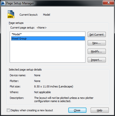

Hi all, I am having issues with what I believe could be a corrupted page setup file. I have gone to the page setup manager to try and delete and re-create, but ANY interaction with the page setup in question causes CAD to immediately lock up and crash (even a right click, somehow). Does anyone know the folder location of these files so that i can go in and manually get rid of one? Thanks
Edit: I am using a windows 7 machine.
Have you tried running the program as administrator?
is it just this file?
Have you tried running an audit?
I'm not sure there is a folder. They are stored in the drawing file.
Do you have all of the service packs hotfixes, and updates for AutoCAD 2013 installed?
Are you saying that you can get to this screen, but if you select the page setup and click Modify, that is when it crashes?
This lisp is supposed to delete those for you. Page setups are kept in the drawing.

(defun c:DELETEALLPS ()
 (vl-load-com)
 (vlax-for ps (vla-get-plotconfigurations
              (vla-get-activedocument
              (vlax-get-acad-object)))
 (vla-delete ps)
(defun deletePS (name)
 (vl-load-com)
   (if (= (strcase (vla-get-name ps)) (strcase name))
   (vla-delete ps)
