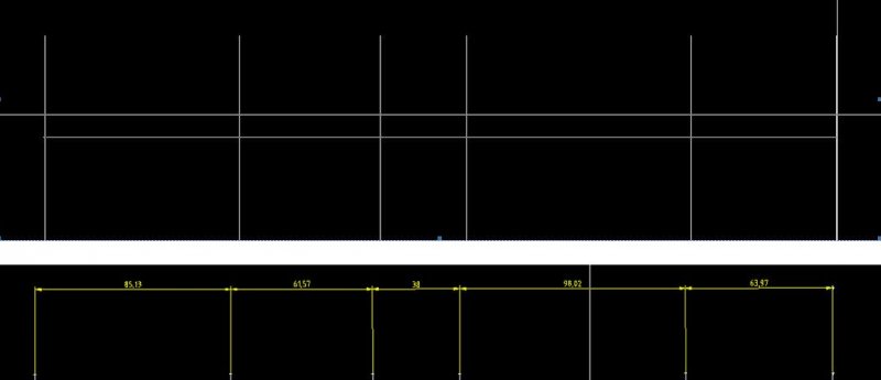

DesmetMartin Posted August 17, 2016 Share Posted August 17, 2016 (edited) Hello all, I wondered if it's possible to have a kind of command or lisp that gets the continue and baseline command in one single command? In the picture below you see the result I need in one command. Now it is done in 2 commands and it's taking a lot of time. Can somebody help me? Thanks! Kind regards, Martin Edited August 17, 2016 by DesmetMartin Quote Link to comment Share on other sites More sharing options...
BIGAL Posted August 18, 2016 Share Posted August 18, 2016 A few different ways to do it a suggestion just pick points using a lisp, in dim order, save in a list and run the two dim commands one after the other. pick pt1 pt2 pt3 pt4 dim pt1 pt2, dim pt2 pt3 etc in a loop dim base pt1 pt1v pt2 pt3 pt4 pt5 etc Ps I do the horizontals all in one go just drag a line over the verticals. Its what I call Autodimensioning, sorry its copy right. pretty sure there are versions out there, check maybe www.Lee-mac.com Quote Link to comment Share on other sites More sharing options...
ssdd Posted August 19, 2016 Share Posted August 19, 2016 (edited) (defun c:tt() (setq p1 (getpoint "\nStarting Point") p2 (getpoint p1"\nEnd Point") nn (getint "Number:") lst nil) (if (and p1 p2 nn) (progn (setq lst (dividex p1 p2 nn) sc (* (getvar "DIMTXT") (getvar "DIMSCALE"))) (mapcar '(lambda (x y) (command ".dimaligned" "_non" X "_non" Y "_non" (polar x (- (angle x y) (* 0.5 pi)) (* 5 sc))) (command "_text" "_non" (polar x (- (angle x y) (* 0.5 pi)) (* 5.5 sc)) sc (* (/ (- (angle x y) (* 0.5 pi)) pi) 180.0) (rtos (distance x p1) 2 2) "") ) lst (cdr lst)) )) )(princ) (defun dividex ( s e i / a r sl) (setq r (list s) a (angle s e) sl (/ (distance s e) i) ; ) (repeat (fix i) (setq r (cons (polar (car r) a sl) r)) ) ) Edited August 23, 2016 by ssdd Quote Link to comment Share on other sites More sharing options...
BIGAL Posted August 19, 2016 Share Posted August 19, 2016 ssdd good idea but if the lines are at all different spacings then it won't work. Hence using the fence option. Quote Link to comment Share on other sites More sharing options...
DesmetMartin Posted August 22, 2016 Author Share Posted August 22, 2016 @SSSD: This LISP doens't work... It's not really what I'm searching for, but thanks anyway @BIGAL: I don't get it what you mean.. Quote Link to comment Share on other sites More sharing options...

BIGAL Posted September 10, 2016 Share Posted September 10, 2016 (edited) I am suprised some else has not posted its not that hard, have a look at the images, the dims were done in single pass, it was done using fence and ssget. Edited September 12, 2016 by BIGAL Quote Link to comment Share on other sites More sharing options...

BIGAL Posted September 12, 2016 Share Posted September 12, 2016 Changed post, image quality is not the best but just drag a line over other lines and all dims appear. Took about 2 seconds to do. Quote Link to comment Share on other sites More sharing options...
