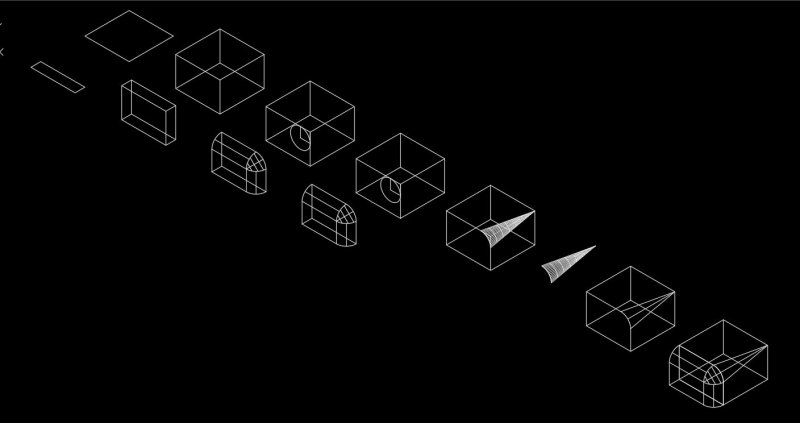

I have a cube that I need to fillet but the fillets must merge.
the left to centre edge/fillet is a constant curve. the same with the bottom to centre edge/fillet. but the edge from centre to the right starts at a radius and goes into a point at the corner.
What command or sequence of commands can create this? Note, the point where the 3 fillets meet must all curve gently.

Here is a depiction of the sequence I followed. I initially divided the 3D model into two parts. The front part was relatively simple as it only required the use of the fillet command. As for the back part the method I used basically relied on lofting one-quarter of a circle (at front corner) and a very, very small right angle (at the rear corner) to create a surface used to slice the edge of the box off. Understand?
2Dwireframe visual style. Isometric view.

Hi Tannar,
Great video, but this does not complete the action required. One of the edges goes from a 3mm fillet at the rounded corner to a 0mm fillet at the other end. Basically it is a variable fillet that changes radii from one end to the other. It looks like a cone has been placed along the edge as ReMark has shown.

I am still unclear as to how the lofting of the quarter circle worked?? What does the very very small right angle do?
You create an arc that is the same as the quarter circle, type loft, select the arc..... then what did you do? This is where I get lost.
Regards
I did a loft between the quarter circle and the small right angle and used the resultant surface that was created to slice off the squared corner of the box. Very simple...very direct.
