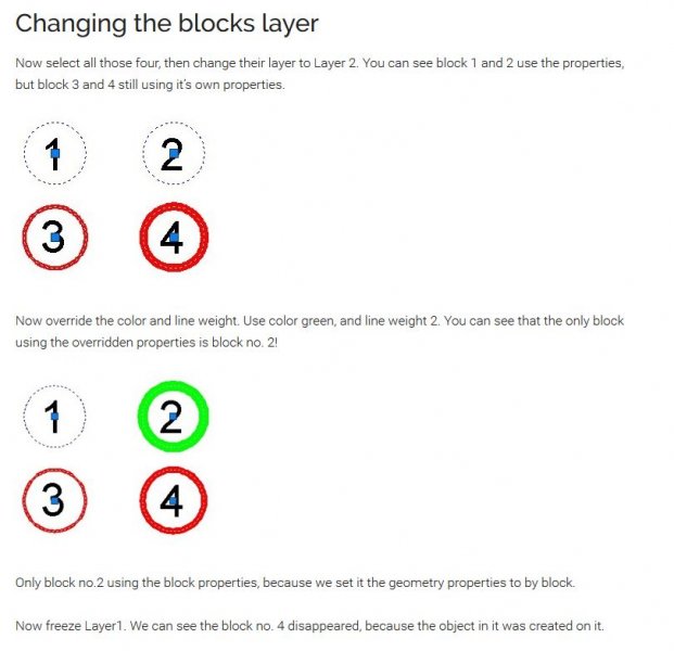

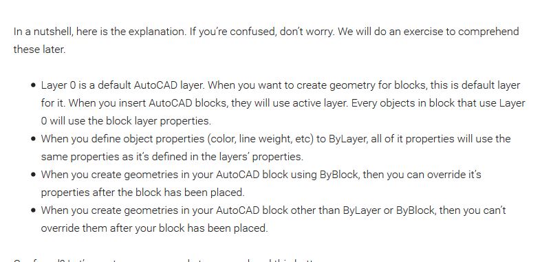

tombu Posted August 12, 2016 Posted August 12, 2016 In blocks setting linework to byblock instead of bylayer gives you a little more control. The block entities on layer 0 will still take on the properties of whatever layer you place it on or move it to, but with byblock it will also take on whatever properties you set it to. This way you can change the properties of just a selection of blocks on that layer. Block entities are what the byblock setting is for. Quote
RobDraw Posted August 12, 2016 Posted August 12, 2016 I've never seen ByBlock used. Don't know why and I've always been curious as to why not. Quote
tombu Posted August 12, 2016 Posted August 12, 2016 This link explains it well: http://www.cad-notes.com/layer-0-bylayer-and-byblock/ Quote
RobDraw Posted August 12, 2016 Posted August 12, 2016 I know why we don't use "ByBlock", now. We use layer properties almost exclusively. Overrides by element are frowned upon with exceptions. Almost everything is "ByLayer" as a rule. Quote
tombu Posted August 12, 2016 Posted August 12, 2016 I know why we don't use "ByBlock", now. We use layer properties almost exclusively. Overrides by element are frowned upon with exceptions. Almost everything is "ByLayer" as a rule. We use layer properties "almost" exclusively here as well. Sometimes blocks on a layer with an odd linetype or too light a color are unrecognizable though and it's nice to be able to make the drawing look any way my boss wants it to. For presentations I'm often called on to make a selection of objects bold or in color to make them stand out. Except for special requests objects in my drawings rarely have property overrides as I use Layer States extensively, but having byblock set for block entities would limit my ability to do whatever's asked of me. Quote

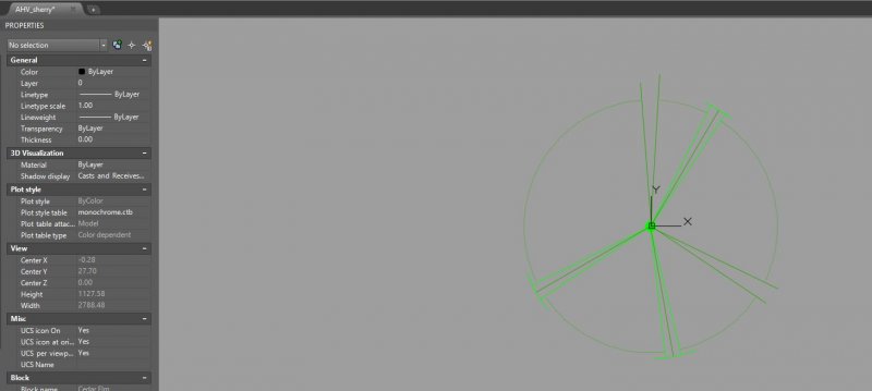

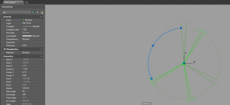

SherryLF Posted August 12, 2016 Author Posted August 12, 2016 (edited) First - I just want to say thank you for hanging in there with my questions. Could you look at these attached images. I've gone into the block to start editing it as we discussed.... When I go into the editor - the block appears to be on layer 0 but if I click on one of the lines, that line is on PM....(which I was going to change to layer 0 with a lineweight change to get the same effect) ... The initial layer 0 is confusing me as I 'thought' the block was drawn on those other layers that I had to turn off in my drawing. Will you explain the differences in these two images? Why is the initial block already set up on layer 0 (or is it?) since its actually drawn on pm (and the other layers) Edited August 12, 2016 by SherryLF duplicated the images - needed only 1 copy Quote

SherryLF Posted August 12, 2016 Author Posted August 12, 2016 This link explains it well: http://www.cad-notes.com/layer-0-bylayer-and-byblock/ Quote
rkent Posted August 12, 2016 Posted August 12, 2016 SherryLF - RE: post 31. first image you haven't selected anything yet, you are simply on layer 0. Use a crossing window to select all the objects, pick on the layer setting and pick 0. Now the objects are on layer 0. Quote
