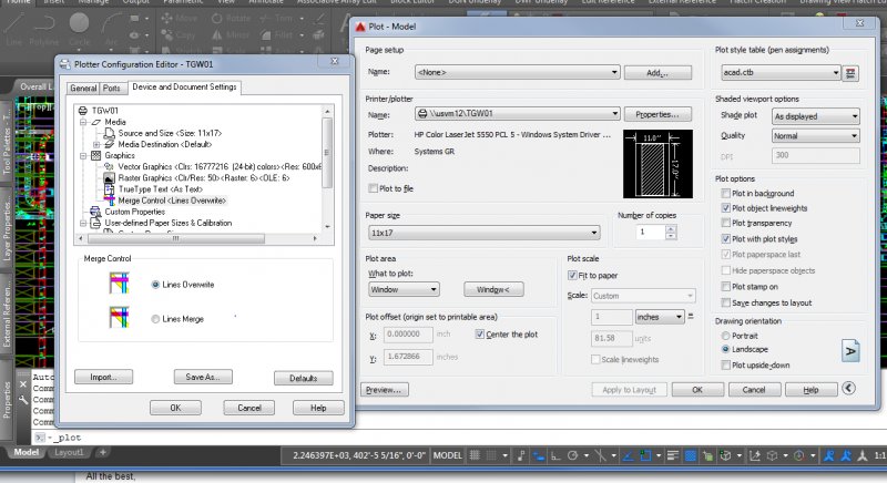

Hi, I have a drawing that incorporates a number of Multileaders that consist of a rectangle with some text inside and a background mask. This drawing is then Xref'd into another drawing.The issue I'm having is that in the main drawing I have frozen some of these. However, the background mask is still showing on the plotted drawings. I've tried to "Select All" to see if something shows up in the drawing, but to no avail. Any ideas? Thanks.

Well, I don't know where to go with it, now. When I freeze the layer through the active viewport, it goes away.

OK, I have verified that the text does have a background mask, and it is the drawing background color by default set in object properties by selecting a simple Yes or No.
Are you by any chance using a crazy whacky personal custom ;)background color in modelspace that the plotstyle simply cannot handle, like a color not included in the index colors?
For instance, your custom plotstyle is of course, missing on my computer so I substituted monochrome.ctb. Because the red 266,0,25 in your company logo is not an index (1 to 255) color, monochrome.ctb skips over processing it, and it plots as red instead of black.
It won't plot for me. Can you post a portion of the file that you are XREFing it into?

Sorry for the late response. I was able to get it to print properly by going into the plotter properties dialog and changing a setting in "Merge Control" to lines overwrite. A colleague of mine says changing this could cause issues with transparencies, but so far I haven't seen anything. Apparently this is a known issue dating back to 2011. Thanks for taking the time to try and figure this out for me.

The Lines Overwrite option can be an issue if you have shaded (screened) objects over ones that plot solid. The shaded one can take precedence creating a break in the solid one.
Thanks for the info. We do have some blocks that are shaded. I'll keep an eye out for issues. You would think Autodesk would have fixed this by now...ha ha ha.
Draw order takes charge in the "Lines Overwrite" thing. The line in front plots, no matter if it is light over dark, the front shows while nothing is plotted behind it. It's not an issue. It is an option.

Checking the "Plot Transparency" box in the plot settings fixed this issue for me.

I had the same exact problem and found that the xrefoverride system variable should set to 0. This solved the problem.
