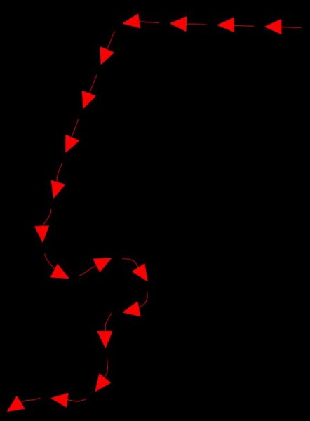

GiiMoo09 Posted August 5, 2016 Share Posted August 5, 2016 Good Day! I was just wondering if there is an available lisp for making a flow arrow just like in the picture I have attached. Right now I'm just drawing it by array command then trimming one by one. copying triangular hatch at each end point and rotating it to its direction. I'm new to AutoCAD and hoping that I can learn some techniques to fasten my work. (especially using LISP) TYI! 1 Quote Link to comment Share on other sites More sharing options...

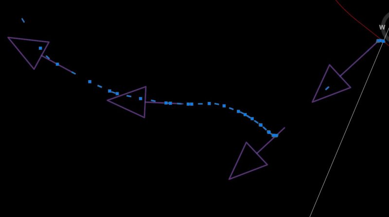

GiiMoo09 Posted August 5, 2016 Author Share Posted August 5, 2016 Thanks for the reply Sir. But I already tried that based on the methods I have searched here in the forum. I used the makeshape and makelinetype command and I got a different result on complicated curves in my PL. Take a look at the picture I attached. Thx. Quote Link to comment Share on other sites More sharing options...

GiiMoo09 Posted August 5, 2016 Author Share Posted August 5, 2016 Thank you jammie and iconio! my only problem now is that how can I make my Arrow line followed the curved path? because it remains straight even in the curve part. BTW. can I include hatch in my mkshape? TY! Quote Link to comment Share on other sites More sharing options...
iconeo Posted August 5, 2016 Share Posted August 5, 2016 Maybe don't have it be one line but series of short lines so it can better follow the arc path. Sent from my SM-G920T using Tapatalk Quote Link to comment Share on other sites More sharing options...

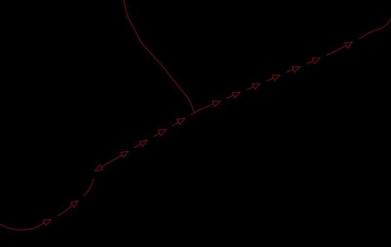

Roy_043 Posted August 5, 2016 Share Posted August 5, 2016 A hatch inside a shape is not possible. But you can create multiple lines to mimic a hatch. Personally I would use the standard 'ZIG' shape: *ARROWS,Arrows -> -> -> A,1,[ZIG,ltypeshp.shx,r=-90,x=-0.25,y=0.25,s=0.25],-1 Quote Link to comment Share on other sites More sharing options...

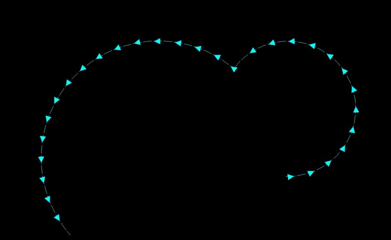

SLW210 Posted August 5, 2016 Share Posted August 5, 2016 Try this one *ARROW,Arrow1 > > > > > > > A,.000001,-3,["\U+25BA",Standard,S=3,R=0,X=-1.35,Y=-1.35],.000001,-4 Works on curves for me, you may need to adjust the LTSCALE and tweak it a little. Quote Link to comment Share on other sites More sharing options...

tombu Posted August 5, 2016 Share Posted August 5, 2016 (edited) Try this one *ARROW,Arrow1 > > > > > > > A,.000001,-3,["\U+25BA",Standard,S=3,R=0,X=-1.35,Y=-1.35],.000001,-4 Works on curves for me, you may need to adjust the LTSCALE and tweak it a little. Looks nice, what font is your "Standard" text style set to? Arial or Times New Roman work ok. Edited August 5, 2016 by tombu Quote Link to comment Share on other sites More sharing options...
SLW210 Posted August 8, 2016 Share Posted August 8, 2016 Our Standard is Arial, Times New Romans will also work. "\U+25BA" is a Unicode character BLACK RIGHT-POINTING POINTER. See THIS and THIS Quote Link to comment Share on other sites More sharing options...
tombu Posted August 8, 2016 Share Posted August 8, 2016 Our Standard is Arial, Times New Romans will also work. "\U+25BA" is a Unicode character BLACK RIGHT-POINTING POINTER. See THIS and THIS We use AutoCAD's Swis 721 Lt BT as it is both compact and easily readable. It only substitutes Unicode characters like "\U+25BA" in Mtext not Dtext or Linetype definitions, while others like "\U+2022" used for solid dot work fine. I have used an Arial text style for when needed. Sad that Complex Linetypes came out one version before Mtext. Had it been the other way around maybe linetypes could reference fonts directly the way you can in mtext. Middle center justification with background mask would eliminate the X, Y, and spacing for text and make using complex linetypes a snap. FileFormat.Info is one of my favorite references as well as ASCII Characters and Web Characters. They're referenced on my home page along with common Alt+ Characters. The two sections of AutoCAD links and shortcuts match my AutoCad background (charcoal) and text (white) colors. Quote Link to comment Share on other sites More sharing options...
