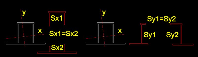

Do you know how to calculate in AutoCAD statical moment (cm^3)
of the selected coordinate system. Best for any figure (region)

Hello
I think that the function massprop provide moments of inertia (cm^4), I am looking for Statical moment (cm^3)
I thought to write a lisp
1. Rotate the figure and in relation to the selected coordinate system and move to 0,0,0
2. divides the object into two parts by an axis
3. creates a region
4. calculates the center of gravity (massprop) and field
5. multiplies, and stores the result
6. Repeat for the second axis
7. Returns to its original position and entered values and will draw the axes for which counted
Unfortunately for me, this is too complicated. Can anyone help

By the definition, static moment is sx=sum[a(i)*y(i)]. For anything else please post a sample with the shapes, axis and results.
Everything is correct

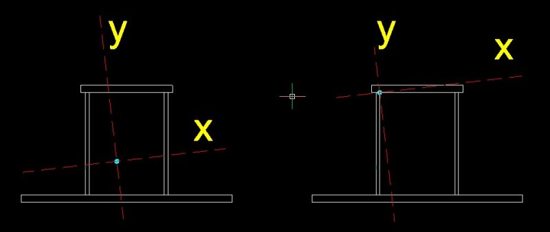

I have enclosed a sketch he can explain what I mean
Almost clear. In your very first post you have an image with the axis origin on top left corner. Obviously, in that case sx1/=sx2. Can you clarify this for me, please?
And one more question, in the last sample, what are you looking for? The axis for which the equality is true?
It probably was not the best sketch.
This sketch is only valid if the layout of coordinates coincides with the principal axes of the object.
I would need 4 data Sx (above and below the axis) and Sy (left and right side of the axis) for any arbitrary coordinate system and the object.
