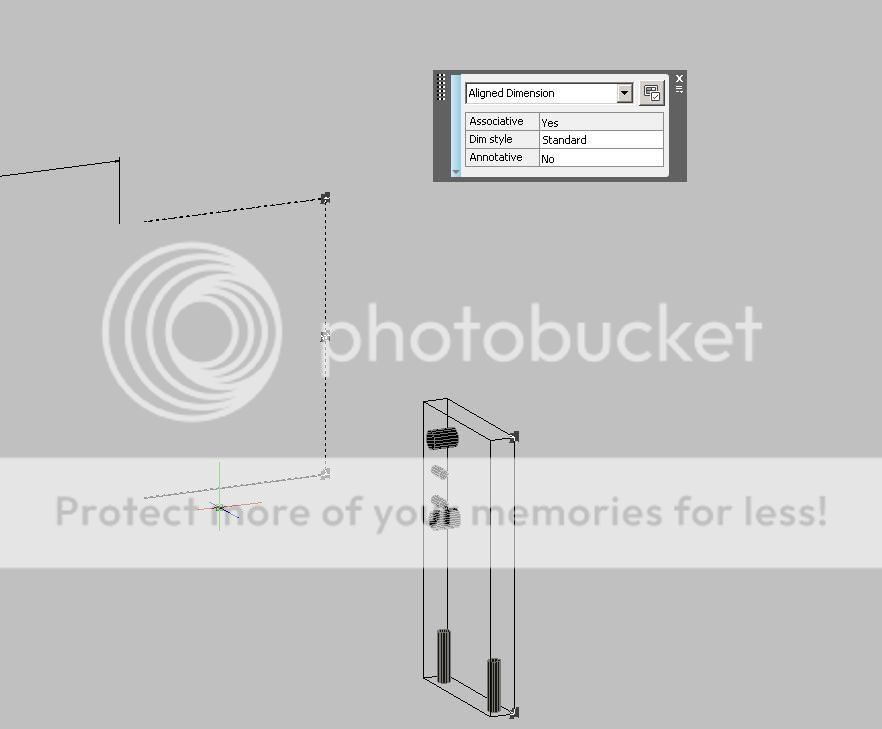

I searched the site and read all the FAQs but I couldn't seem to figure out how to make this work. My problem is getting the annotations where I want them.
As you can see the leads are in the right place, but I can't get the Annotation to move over to it..
If anyone can tell me how to do that, I'd appreciate it.
Thanks.

You forgot to attach the dwg.
F1
ucs
Jd is giving you a hint. I'll elaborate:
Your UCS origin z needs to be on the same plane that you wish to place the dimension.
