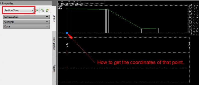

How to get a point location of Section View?
Section View is an object existing only in Civil 3D.
I am looking for the properties using:
(defun c:prop (/ p1 p2)
 (vl-load-com)
 (setq p1 (vlax-ename->vla-object (car (entsel))))
 (setq p2 (vlax-get-property p1 "Parent"))
 (vlax-dump-object p2 'T)
Looking coordinates of a point in the image.
Have you looked into the following two methods that are provided for SectionViews?
; FindStationOffsetAndElevationAtXY (6)
; FindXYAtStationOffsetAndElevation (6)
It isn't very clear to me what you are trying to do though.
