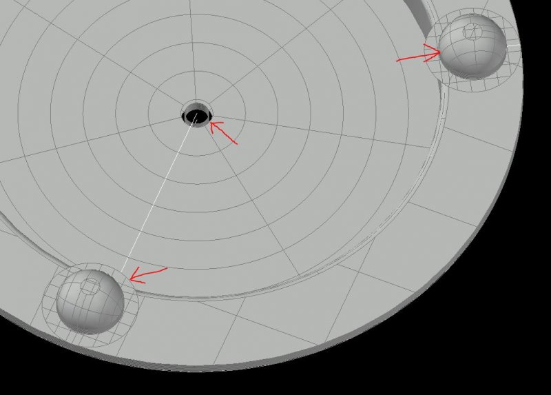

Moving on to the attachment plate. What can you tell me about the objects (or lack thereof) going on where you see the three red arrows?

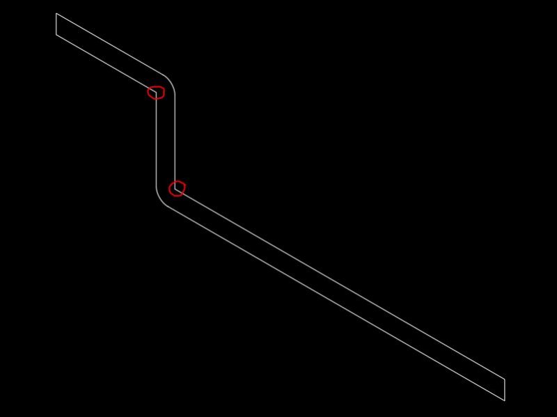

Regarding this profile...you did not apply a radius to the two areas circled in red. Was that intentional?

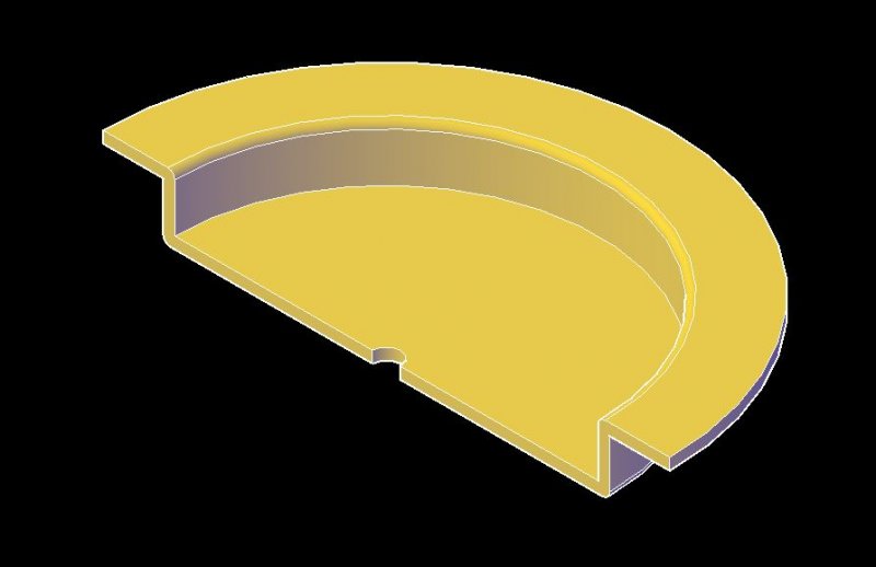

Back to the attachment plate. Here's a 180 degree cutaway; it's a 3D solid. I'll need some direction regarding the three "domes" and what is supposed to be under them. I'm assuming they are hollow. What is the wall thickness? Are the circular disks under them of any particular thickness? Are they flush with the top of the plate or do they sit on top of it like a raised disk?
