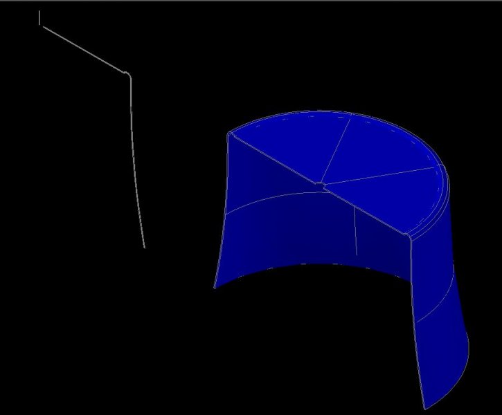

ReMark Posted January 9, 2017 Posted January 9, 2017 (edited) Too bad you weren't closer to North Charleston. I may be visiting SC in April. I'd swing by and have a beer with you. So back to your drawing. Looks like you have two objects that are solids...the handle and the two o-rings. Everything else is either a surface or a revolved surface. Typically if you extrude, or revolve, a line or series of lines you'll end up with a surface. If however you extrude, or revolve, a closed (polyline) profile you'll end up with a solid. Edited January 9, 2017 by ReMark Quote

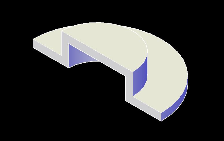

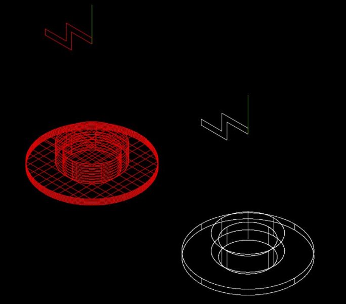

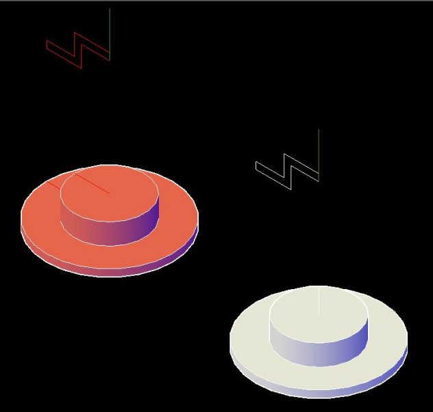

ReMark Posted January 9, 2017 Posted January 9, 2017 Two examples both showing a revolved series of lines (on the left) versus a revolved profile consisting of a single continuous polyline (on the right). Result = revolvedsurface (on the left) and a solid (on the right). The pale green line you see represents the point I used for revolving the entities. Example 1 (visual style: 2Dwireframe) > Example 2 (visual style: Conceptual) > And here is an example of what the solid would look like if we sliced it in half. Visual style: Conceptual. Quote

ReMark Posted January 10, 2017 Posted January 10, 2017 (edited) So u are suggesting starting over? Not necessarily. If you have retained the individual lines that you used to create the surfaces they can be turned into polylines then joined to create a half profile that can then be revolved thus yielding a solid. Other methods of converting surfaces to solids include... -THICKEN -SURFSCULPT -CONVTOSOLID I've changed my mind. Start over. I can't quite seem to figure out what you did with the cylindrical objects. Perhaps when I get a moment I'll approach the problem differently. Edited January 10, 2017 by ReMark Quote

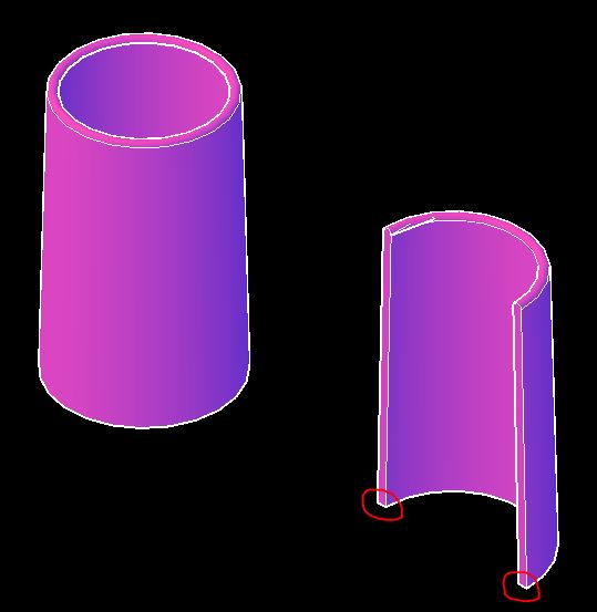

ReMark Posted January 10, 2017 Posted January 10, 2017 OK...let's talk about the vacuum cylinder. I recreated it as a 3D solid model. What I want to know is, where you see the two red circles, is there supposed to be a space between the inner and outer walls? It appears that in your surface model there was. I don't know if that was intentional or not. Quote
Robert Newton Posted January 10, 2017 Posted January 10, 2017 Indeed, I tried to simulate a 1/8" space between the two walls thus creating a vacuum. I must have got that part right, else u would not have picked up on it. Ok, I will start over. Quote
ReMark Posted January 10, 2017 Posted January 10, 2017 So what is the thickness of each wall supposed to be? Quote
Robert Newton Posted January 10, 2017 Posted January 10, 2017 I am attempting .014 wall thickness. Quote

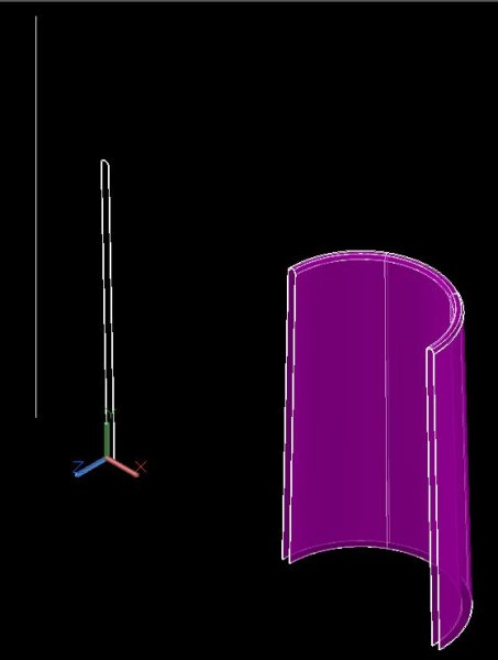

ReMark Posted January 10, 2017 Posted January 10, 2017 OK. I think I got it. I created the profile, on the left (in white), turned it into a region using the REGION command then revolved it (180 degrees in this case). The walls are .014 thick and the space between them is .125 as per your posts. Visual style = X-ray Here is a close up of the upper portion of the cylinder. Visual style = Realistic. I used the COLORFACES command to change the color of the interior face of the outer wall. Quote
