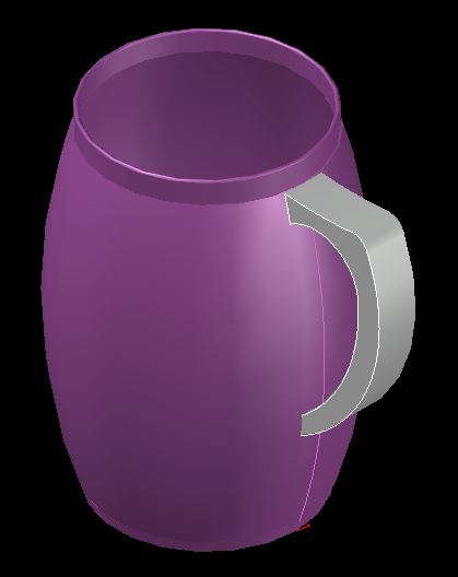

Robert Newton Posted January 9, 2017 Posted January 9, 2017 Cad, I am doing my best to get the handle one the ceramic housing (the red or orange) and having a helluva time this being my first attempt at 3D. And while I got you and u may be looking at the drawing u will probably notice I was successful in putting holes (one on other side as well) in the blue part. I need to duplicate that about 1/2" up from the existing one (that happens on both sides as well. And further more , there needs to be a 1/2" square hole to the left of those holes (near side only) about 1" over from hole center to edge of hole. You and others have been very patient and helpful and I really appreciate it.I have been working on trying to do this about 4 days and am about ready to pull out the rest of my hair. If you don't have the time or don't wanna fool with it I understand and again I appreciate you and others. 1st 3D Model.dwg Quote

ReMark Posted January 9, 2017 Posted January 9, 2017 Is this one of the things you are attempting to do? Quote
Robert Newton Posted January 9, 2017 Posted January 9, 2017 Indeed it is Re; I wanted to put some radii on the corners of the handle but couldn't get that to work either. The only thing different from my original 2D dwg. is that I had the handle about 1/2" inch lower than what u are showing. Thanks for your patience and help Re Quote
ReMark Posted January 9, 2017 Posted January 9, 2017 The handle is a solid so you should be able to use the FILLET command to radius any corners. However, the upper and lower portions of the handle where you make contact with the cylinder don't quite match up to the cylinder's curvature. That would have to be fixed. BTW...in some cases it is possible to use either the THICKEN command or the SURFSCULPT command (must be a watertight surface) and end up with a solid. Quote
