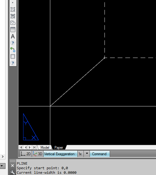

cat3appr Posted July 22, 2016 Posted July 22, 2016 hello I'm having quite an headache from this: I need to copy in paper space a dwg that I have in model space, but I don't succeed to get it in the right place. My scale is 1:2000 so I know that by copying from model space i have to scale down 0.5 in paper space. The 0,0 in paper space is the bottom left corner, but I don't succeed how to place exactly my block title from model space as it is, in the same position in paper space.... anyone has any idea? thanks! Quote

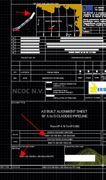

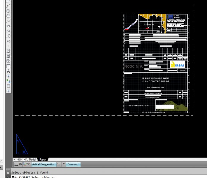

cat3appr Posted July 22, 2016 Author Posted July 22, 2016 either i don't understand how to use this CHSPACE, or it doesn't work in my situation. this is what i did: i created a viewport in paper, around the area in which there are the objects i want to transport from model to paper. then i wrote CHSPACE, i was asked to select the objects, and i could only select the view port, so i did. then, enter. i then went to model, erased everything, because i cant have anything there, and i was expecting to see the objects in the viewport in paper space.... but... everything got erased there too basically i need to transport a few texts and the hatch, see red arrows, from model to paper, exactly in that position, how does this work? Quote
RobDraw Posted July 22, 2016 Posted July 22, 2016 Before starting the command, activate the viewport. Quote
cat3appr Posted July 22, 2016 Author Posted July 22, 2016 Before starting the command, activate the viewport. activate? if i draw a viewport and it's already there and working, i assume it's already active ... and how do i activate? please guide me step by step Quote
ReMark Posted July 22, 2016 Posted July 22, 2016 Before starting the command, activate the viewport. It actually says that in the link I provided. It pays to carefully read and follow the instructions. Quote
RobDraw Posted July 22, 2016 Posted July 22, 2016 Double click inside the viewport to activate it. It sounds like you could use a class or two or some tutorials for basic AutoCAD. Quote
cat3appr Posted July 22, 2016 Author Posted July 22, 2016 It actually says that in the link I provided. It pays to carefully read and follow the instructions. how do i activate a viewport.... do you mean that i have to select it with the mouse? this is what i did, i selected the viewport, then CHSPACE... doesn't work. Quote
cat3appr Posted July 22, 2016 Author Posted July 22, 2016 ok apologies.... thanks to all, i got it now, my mistake Quote
