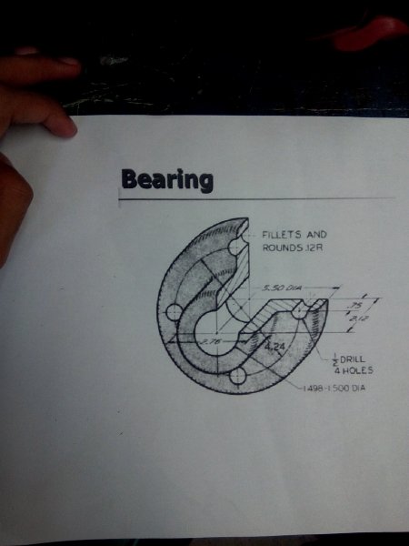

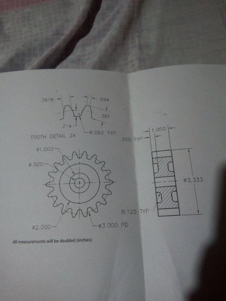

shadowblitz3 Posted July 21, 2016 Posted July 21, 2016 need help in my final plate, make this figure into oblique view with the upper right part removed similar to this one Quote
ReMark Posted July 21, 2016 Posted July 21, 2016 (edited) Does the assignment instructions actually use the word oblique? Personally, as regards the object (gear) you must draw, I don't see the benefit to creating an oblique view. In this situation I'd say an isometric view would be more preferable. Edited July 21, 2016 by ReMark Quote
shadowblitz3 Posted July 21, 2016 Author Posted July 21, 2016 well our instructor literally just said make a view of the object similar to that of the second figure's which I thought was in oblique view Quote

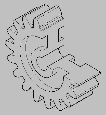

ReMark Posted July 21, 2016 Posted July 21, 2016 Since he said "similar" I might interpret that as being isometric. Who's to say? So, for example, you might have this... Add a little hatching and you're done. Quote
shadowblitz3 Posted July 21, 2016 Author Posted July 21, 2016 it should be in oblique/cavalier view apparently according to a classmate I asked Quote

rkent Posted July 21, 2016 Posted July 21, 2016 Quote well our instructor literally just said make a view of the object similar to that of the second figure's which I thought was in oblique view You are correct and you have a good example of what is wanted. What help are you actually needing? You draw the gear front view and then receding lines all at a common angle. Quote
ReMark Posted July 21, 2016 Posted July 21, 2016 Simple diagram explaining the concept of oblique projection. http://www.technologystudent.com/designpro/oblique1.htm Quote
lrm Posted July 21, 2016 Posted July 21, 2016 Make a front view drawing of the object then make a copy of it at and angle of 45° up to the right a distance of 0.75. Make another copy at an angle of 225° (45° down to the left) a distance of 1.37 (2.12-.75). Then edit as necessary. Quote
ReMark Posted July 21, 2016 Posted July 21, 2016 I think the OP has to create an oblique view of a gear. Quote
