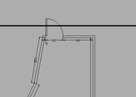

MillerMG Posted July 13, 2016 Posted July 13, 2016 billydavies21 said: Miller, 1:20 threw me out. The premises is so large, I can't see how it would fit on A3 at 1:20. one of the walls is 24m so dividing that by 20 to get the 1:20 would make it 120cm long, which is far too big for A3 printing! at 1:150 it makes it 16cm, far better for A3. Maybe I misunderstood what you were trying to do. All I know is that I have a headache and need a beer! When I made the PDF I put it on A3 Quote
ReMark Posted July 13, 2016 Posted July 13, 2016 Not sure if I am doing this right, as I don't work in metric units, but although I have an A2 size sheet I can't quite get the entire property to fit on the page at a scale of 1:100. I'm using a layout with a single viewport. I am not doing this in model space. Unfortunately the dimensions are too small to be readable. This could be fixed in one of two ways. Leave them in model space but change some of the dimension style settings or erase all the dimensions in model space and instead place them in the layout (the method I normally use). A quick test of doing this way confirms the dimensions match those shown. OK...I could make it fit an A2 sheet if I were to use a paper size of ISO A2 Borderless. Quote

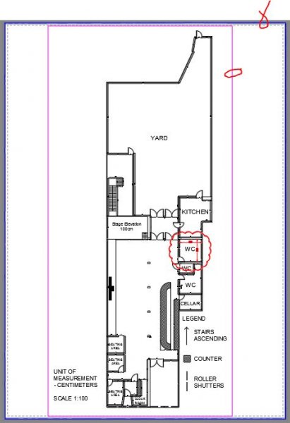

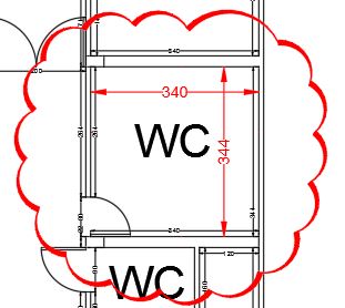

ReMark Posted July 13, 2016 Posted July 13, 2016 This is what the overall layout looks like. The blue rectangle is the edge of the paper. The magenta rectangle is the single viewport. A viewport is merely a window that let's us see the objects we created back in model space. The red cloud around the area labeled W.C. is where I added a couple of dimensions in my layout not in model space. Note that they agree with your model space dimensions. A closeup is provided below. Quote
billydavies21 Posted July 13, 2016 Author Posted July 13, 2016 H2O (3).dwgFetching info... Ok, I'm still not quite understanding the point of the viewport, or the difference between viewports and model space. Thanks for those dimensions. Didn't notice they were missing. I've added them to my DWG, which I've uploaded. So this still leaves me with my problem. Is it possible to put a 1:100 scale version on A2? I'm obviously not understanding something. Again, putting it down to the fact that I'm trying to run another business at the same time... Thank you for your help so far ReMark. If you've figured it out and can make the drawing fit to A2, would you mind exporting to PDF and uploading it please? I would be extremely grateful! Quote
ReMark Posted July 13, 2016 Posted July 13, 2016 There is model space (where your geometry is created and resides) and there is something called a paper space layout. Most people just refer to the latter as "layout". This is where one would place their title block and border. We create viewports (a.k.a. - windows) in our layouts so we can view the objects we created back in model space. Now, many users prefer to place their text and dimensions in model space while some of us prefer to place them in the layout. There are pros and cons to each method. All I can say is if one is going to be using AutoCAD on a regular basis then one should investigate each method and decide for themselves which works best in their given situation. Think of a layout as being the inside of your house. Think of a viewport as being a window in your house. Everything that exists on the outside of your house is in model space. As you move closer to or further away from the window your view of the outside and the objects you can see will change. The objects (ex. - your car, a person, trees, etc.) don't get smaller or bigger on their own (i.e. - they did not physically change their size). Your dimensions weren't missing after all; they were just so small they were not easy to read given the method (i.e. - layout) I am using. Since I don't work in metric I don't know if I have accurately arrived at the correct solution to your problem although as I pointed out I did select an A2 sheet size and have managed to fit (to scale I believe) your drawing within my viewport and ultimately the confines of the paper. Quote
