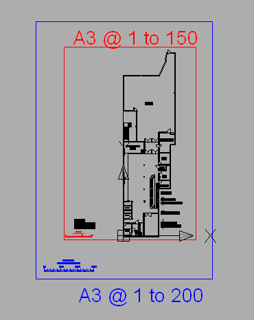

billydavies21 Posted July 12, 2016 Author Posted July 12, 2016 The plan is drawn to scale in AutoCad. I set the units to cm and went at it. I just need it exporting to a PDF so that when it prints at A3 size, it's in a scale that I can identify and tell the council and when they measure it, they say "yes it's in that scale". I thought that is what your PDF was. If not, then I probably shouldn't have just sent it to the solicitor dealing with it... Quote
eldon Posted July 12, 2016 Posted July 12, 2016 (edited) Perhaps this is something like you want. (Do not let on to anyone, but I plotted them from Model Space without using viewports, but that is another story). Learn about viewports and keep an eye on the scales. AutoCAD plots in millimetres and one centimetre is 10 millimetres. H2O-A3 at 1 to 150.pdfFetching info... H2O-A3 at 1 to 200.pdfFetching info... Edited July 13, 2016 by eldon corrected centimetres to millimetres, and nobody yet noticed!! Quote
billydavies21 Posted July 12, 2016 Author Posted July 12, 2016 Eldon, thank you so much! So if the council were to print this straight onto A3, it would be 1:150/1:200 and when they get their rulers out, it all works out? Sorry I'm being so dumb. I'm also doing my normal work (which is very time consuming itself!) and keep flitting back to this as it's so urgent. Quote
eldon Posted July 12, 2016 Posted July 12, 2016 billydavies21 said: ....So if the council were to print this straight onto A3, it would be 1:150/1:200 and when they get their rulers out, it all works out?.... I expect that the council would be practised at printing out to scale. The thing to watch out for is that most people print with the Page Sizing and Handling set "To Fit". These PDFs must be printed out "Actual Size", and then the scale bars will work with a scale rule. Quote

BIGAL Posted July 13, 2016 Posted July 13, 2016 My $0.05 Like Eldon went to a layout created a new viewport 420,297, rotated 90, zoom e, something not right, inside window, UCS W plan, Z E, ok getting somehwere, did Zoom 0.05xp. this is true scale now 1:200. Plot, window, pick corners, scale 1=1, centered, note the Button > bottom right click on it, choose portrait. Should be perfect. zoom 0.05xp the 0.05 in metric is a realtionship to 1m = 1000mm. We work mainly civil so in metres so the scale factor is easy 1;200 = 1000/200= 4 Quote
eldon Posted July 13, 2016 Posted July 13, 2016 Drawing in centimetre units makes extra factors of 10, and this is tricky if you are not used to it. Drawing in millimetre units would allow you to see whether the scaling was want you wanted, because AutoCAD is set up for millimetres. Quote
