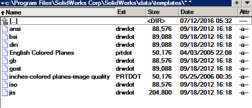

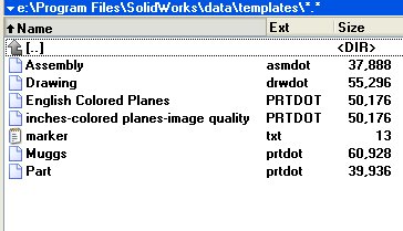

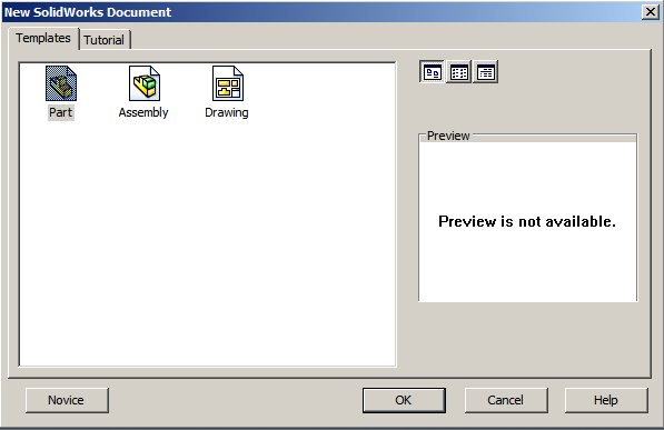

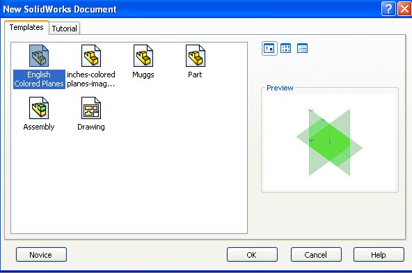

I enclose the data from both version 2007 and 2013 to show that I do have the right extensions and path,
version 2007 works ok.

Something must have changed between 07(never used that version) and 2013. The 07 directory looks fine but in the 2013 one notice that its all drawing standards. This is where solidworks is looking for drawing standards and not part/assembly/drawing templates. In the newer versions the directory will be hidden but should be c:\ProgramData\SOLIDWORKS\SOLIDWORKS 2013\templates. Type that into your windows explorer and see if its a valid folder. If not just put in ProgramData. You should see a Solidworks folder. Inside that will include any solidworks versions(2015 and 2016 currently on my system) as well as any addin or standalone products you have.

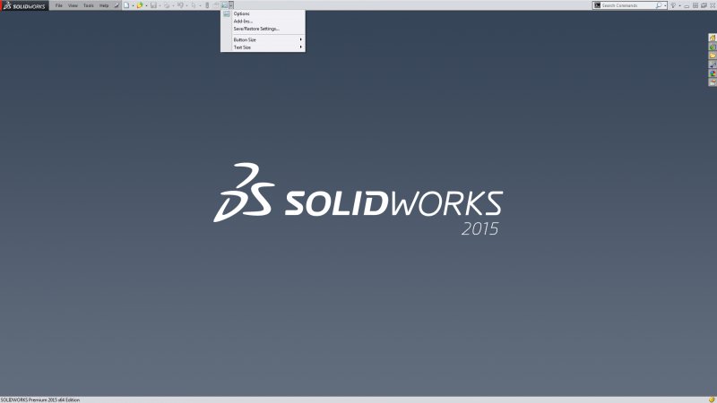

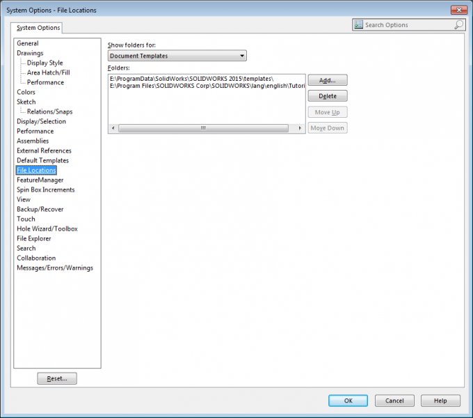

As far as the "Pointing to a location". I don't remember off hand if you could get to it from the File Menu but it should be the same as the attached images from SW2015. 2016 changed the icon to a little gear but it was the one in the image for several years. From the "Options" you will go to System Options. If you have a file open there will also be a tab for Document specific properties but you aren't interested in those. Navigate down to "File Locations" There is a drop down which, by default, will be on Document Templates. You can then add any folder to that list. The result is that when you start a new file you will have another TAB. Default will have one called Tutorials and one called templates. Make sure if you add another folder to give the folder name something meaningful like Custom Templates. This will also tell you where solidworks is currently looking for those document templates.

Using shift1313's screenshot as a reference, I recommend deleting any locations except where you have your templates.

I dont agree. Dont delete the default template locations if thats what you are saying. You can remove the file location from solidworks so it doesn't use them.
I typically have a templates folder on another drive and a zipped up backup of any custom templates, sheet formates and weldment profiles. Because I do this for customers I know everyone is different but isolating templates helps during upgrades.
