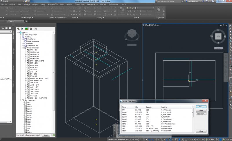

I place custom manhole which is modified from default structure "AeccStructRectSlabTopRectFrame_Metric.dwg".

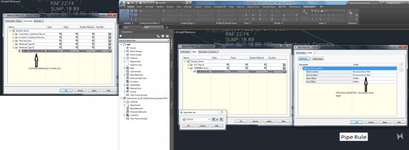

It's work when I place custom manholes with pipes , and set pipe rule end location as center to center. However, when pipe end location is modified to structure inner wall, fatal error will be occurred.
Please find the attached pngs for your reference. Thx.
C3D 2017
Win7
