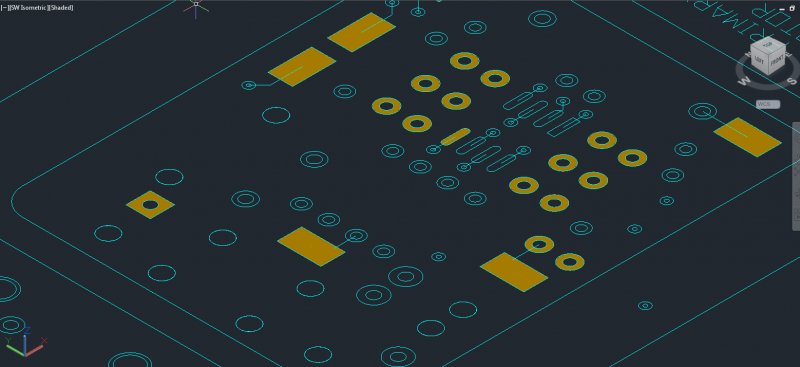

This will give you an idea of the results to be achieved. I want to get 3d copper on all the pads using the 2d outlines from a layer top_copper and do the same for a bottom copper layer.
This so far was done manually and involves a lot of steps.
Yes, I can see where it would involve a lot of steps especially considering it is being done after the fact. So is it true that only circles, ovals and rectangles that are of a certain size would have to be converted to a 3D solid or would all of them have to be converted?
It is all the rectangles and ovals that do not have a circle inside to become solid boxes or round end boxes. The rectangles, oval or circles with a circle inside need to become donuts etc.
The single lines or single circles do not need a solid being created. As these are plain holes or traces that do not need to be shown.
I have only partly completed the pads in this picture, all the various sized double circles need to be completed too. That is why I was hoping to create a script, LISP or other code that could do this work for me as it is a long slow process doing it manually.
