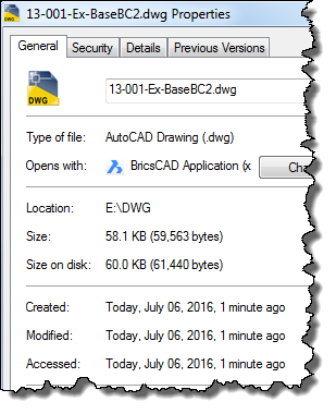

rkmcswain Posted July 6, 2016 Share Posted July 6, 2016 https://dl.dropboxusercontent.com/u/716765/Xref%20Base.zip There were still over 700 entities in this file, and over 600 C3D styles. I ended up with ±same results as @ReMark. ±240kb -- Using SuperPurge as a brute force tool. Nothing remarkable about the bloat, looked like general stuff. Opened in BricsCAD, erased the entities, purged, then Export to DWG and the result is ±59k Quote Link to comment Share on other sites More sharing options...
Silvercloak Posted July 6, 2016 Author Share Posted July 6, 2016 There were still over 700 entities in this file, and over 600 C3D styles. I ended up with ±same results as @ReMark. ±240kb -- Using SuperPurge as a brute force tool. Nothing remarkable about the bloat, looked like general stuff. Opened in BricsCAD, erased the entities, purged, then Export to DWG and the result is ±59k [ATTACH=CONFIG]58518[/ATTACH] Dang - that's awesome... I'll take a look at this tool. Although - it's obvious there's way too much detritus in these files. I need to find a way to keep the working files intact while disposing of the excessive bloat. Will superpurge do that or will it damage the essential purpose of these drawings? Silvercloak Quote Link to comment Share on other sites More sharing options...
