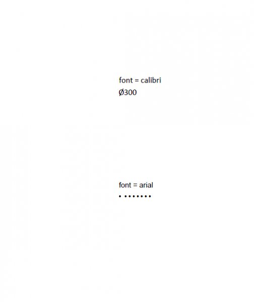

not sure if this is the right place for this, but i'm having a few text issues publishing to pdf..

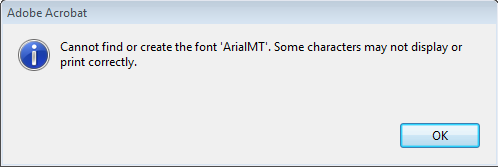

its coming up with this msg saying "Cannot find or create the font ArialMT. Some characters may not display or print correctly"
I've attached an image of the msg
Seems to occur when I've used any symbols (example attached - works ok with Calibri, but not Arial). Would have thought the arial font would be common enough for this kinda thing not to happen.
Either way does anyone know how to fix this issue other than choosing a different font?
