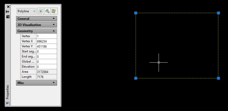

I don't need to "if loop", because all my polylines are closed. (Shown in picture):unsure: kolon.jpg

Thank you for your interest. It works except length. It gives the length of closed polyline 0.0000 .
I need a length code for closed polyline :cry:
