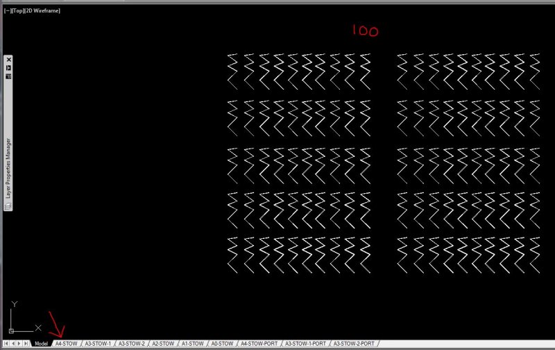

ReMark Posted June 21, 2016 Share Posted June 21, 2016 (edited) Your drawing with 100 copies of your test block. File size: 388KB. If what you said in your first post was true then the file size should have been substantially bigger right? I think part of the problem is the "junk" in your drawing. The other part of the problem might be the nine layouts but that is questionable at the moment without further investigation. If I strip out the layouts and retain the 100 blocks I can get the file size down to a mere 68KB. Addendum: After going back through your drawing, specifically the layouts, I think the increase in file size is due, in part, to the logo (seen in the image below) that is part of each title block and border block. If you strip out everything except one instance of this logo, save it as a drawing and check the file Properties you'll see it is approximately 80KB. Create eight more copies, save it as a new drawing, and check its file Properties you'll see the file size grow to approximately 248KB. And that's just the logo all by itself. It does not include any of the linework or text that goes into creating each of the title blocks and borders. BTW...I'd recommend opening each title block and border drawing separately and running the OVERKILL command on it. You'll find duplicate and overlapping objects of 2 & 15, 1 & 4, 10 & 4 and 2 and 16. I'd also recommend running the -PURGE (note the dash in front of the letter "P") command on your drawing (i.e. - Testblock-1) purging Regapps first then repeating the command but doing a purge > All. A clean drawing is a healthy drawing. Finally, run the AUDIT command to check for and fix any database errors just as added insurance. Well that's my assessment any way. Edited June 21, 2016 by ReMark Quote Link to comment Share on other sites More sharing options...
