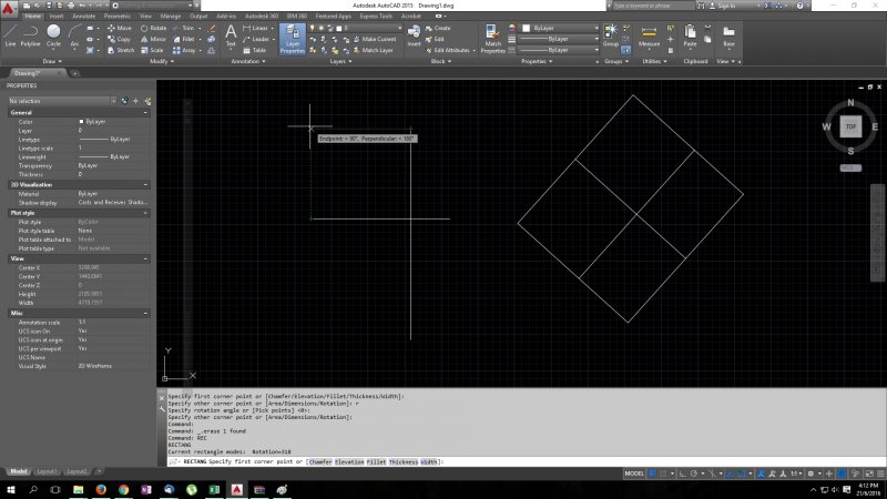

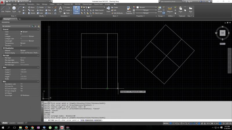

avarte Posted June 21, 2016 Posted June 21, 2016 Hi Everyone, I'm very new in writing lisp, but I was trying to write a lisp that could help me draw a rectangle using the perpendicular reference point of 2 polyline. Attached is a picture of how I want to draw it. It's hard to draw the rectangle using just the onsnap. I was wondering if I could just click on the 2 end points of the polyline and the other direction's polyline to draw the rectangle. Quote
Tharwat Posted June 21, 2016 Posted June 21, 2016 Try this and let me know: (defun c:Test (/ s ss a b c d ins lst) ;; Tharwat - Date: 21.June.2016 ;; ;; Draw closed LWpolyline from the two selected ;; ;; LWpolylines and they must be straight. ;; (defun _straight-p (e / l q a) (setq l (mapcar 'cdr (vl-remove-if-not '(lambda (p) (= (car p) 10)) (entget (ssname e 0)) ) ) q (car l) a (angle q (cadr l)) ) (apply 'and (mapcar '(lambda (pt) (and (equal (angle q pt) a 1e-4) (setq q pt))) (cdr l) ) ) ) (princ "\nSelect 1st LWpolyline :") (if (and (setq s (ssget "_+.:S:E" '((0 . "LWPOLYLINE")))) (_straight-p s) (princ "\nSelect 2nd LWpolyline :") (setq ss (ssget "_+.:S:E" '((0 . "LWPOLYLINE")))) (_straight-p ss) (setq a (vlax-curve-getstartpoint (ssname s 0)) b (vlax-curve-getendpoint (ssname s 0)) c (vlax-curve-getstartpoint (ssname ss 0)) d (vlax-curve-getendpoint (ssname ss 0)) ) (setq ins (inters a b c d)) ) (progn (mapcar '(lambda (j k) (setq lst (cons (list (polar a j k) (polar b j k) ) lst ) ) ) (list (angle d c) (angle c d)) (list (distance ins c) (distance ins d)) ) (setq lst (apply 'append lst)) (entmake (list '(0 . "LWPOLYLINE") '(100 . "AcDbEntity") '(100 . "AcDbPolyline") '(90 . 4) '(70 . 1) (cons 10 (car lst)) (cons 10 (caddr lst)) (cons 10 (last lst)) (cons 10 (cadr lst)) ) ) ) (princ "\nLWpolylines must be straight and crossed !") ) (princ) )(vl-load-com) Quote
Lee Mac Posted June 21, 2016 Posted June 21, 2016 Here's another way to write it: (defun c:myrect ( / int pl1 pl2 pt1 pt2 pt3 pt4 ) (if (and (setq pl1 (ssget "_+.:E:S" '((0 . "LWPOLYLINE") (90 . 2)))) (setq pl2 (ssget "_+.:E:S" '((0 . "LWPOLYLINE") (90 . 2)))) ) (if (setq pl1 (entget (ssname pl1 0)) pl2 (entget (ssname pl2 0)) pt1 (cdr (assoc 10 pl1)) pt2 (cdr (assoc 10 (reverse pl1))) pt3 (cdr (assoc 10 pl2)) pt4 (cdr (assoc 10 (reverse pl2))) int (inters pt1 pt2 pt3 pt4) ) (entmake (list '(000 . "LWPOLYLINE") '(100 . "AcDbEntity") '(100 . "AcDbPolyline") '(090 . 4) '(070 . 1) (cons 10 (mapcar '+ pt1 (mapcar '- pt3 int))) (cons 10 (mapcar '+ pt1 (mapcar '- pt4 int))) (cons 10 (mapcar '+ pt2 (mapcar '- pt4 int))) (cons 10 (mapcar '+ pt2 (mapcar '- pt3 int))) ) ) (princ "\nLines do not intersect.") ) ) (princ) ) Quote

avarte Posted June 23, 2016 Author Posted June 23, 2016 Thank you so much guys. Didn't think I would get a responds that quick. Thank you so much. I get why my previous codes didn't work. Learned a lot from you guys. Thank you again. Quote
