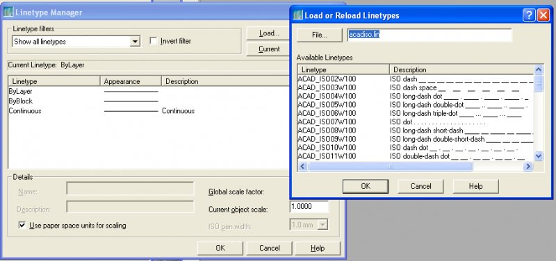

davidoff Posted June 20, 2016 Posted June 20, 2016 Hello, I have a series of lines that I need to convert to hidden lines. Please let me give you the sequence that I used. I typed ltype at the command line and when my Linetype Manager window came up I selected Load, then the hidden lines I wanted. I then went into Modify Properties, selected linetype, the hidden that I selected, and x'd out of it. The lines remained solid. I would appreciate someone telling me what I am missing. I am using Autocad 2000 if it at all matters. Thank you, Ahmad Davidoff Quote

eldon Posted June 20, 2016 Posted June 20, 2016 I typed ltype at the command line and when my Linetype Manager window came up I selected Load, then the hidden lines I wanted..... What File name was shown when you selected Load? Quote

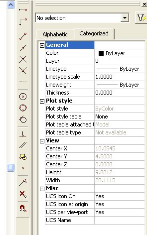

davidoff Posted June 20, 2016 Author Posted June 20, 2016 My default setting is English Feet and Inches. I am using version 2000. I enclose a screen shot of my window. Quote

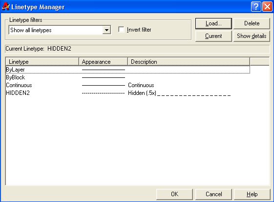

davidoff Posted June 20, 2016 Author Posted June 20, 2016 I am enclosing the file itself. I tried changing the scale by typing ltscale at the command prompt and changing the scale to .0025 with the same result. Aim 80AU 20Sn Material.dwg Quote

ReMark Posted June 20, 2016 Posted June 20, 2016 Change the global linetype scale to a value of "1". Currently you have it set at 0.0025! Can I make a suggestion? Try using different layers for the various parts of your drawing instead of drawing everything on layer "0" and then overriding the color and linetype features of the layer? It would make your life so much easier. Quote
eldon Posted June 20, 2016 Posted June 20, 2016 In the drawing posted, there are no entities with the linetype Hidden2. Quote

tmelancon Posted June 20, 2016 Posted June 20, 2016 After checking out your drawing. Your LTscale is seems entirely too small. I tried 0.5 LTscale and it looked great. Quote
tmelancon Posted June 20, 2016 Posted June 20, 2016 Yikes, let me elaborate.. Ok sorry, I noticed your Global Scale Factor is 0.0025. This needs to be changed to 1.0000 first. Then select your object and change LTscale to 0.5. This will yield the result I got on my end. Quote
