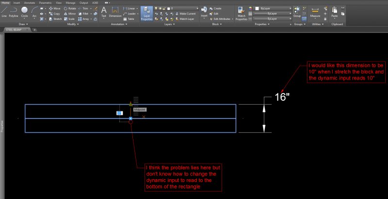

I created a simple 2D plan view dynamic block of a steel beam in a zero layer (white line) and the beam flange in a non-plot layer (gray rectangle). I have a problem with the block when I set my increments or distance for the flange (gray rectangle) the block does not behave the way I want to. I want the rectangle to stretch from 4 inches to 16 inches at increments of 2". My goal is to stretch the rectangle at 4", 6", 8"....16". I see that when I stretch the rectangle the stretch distance is taking from the bottom of the rectangle and remains there no matter what I do. How do I fix this? See attached.

Just to clarify: You want the "middle line" to be central between the other two, and for the total height to vary from 4" to 16" at 2" intervals?

Do you intend to use the same flange thickness on this diverse range of beams?
Would you consider using MultiLine styles instead of a dynamic block?

No, I intend to use different flange width (not thickness). MultiLine styles wont work because I want to add visibility states to the dynamic block showing symbols such as moment connection, pin connection, etc. Once I achieve my goal I am planning to upload it for sharing. This is something I can do in this website, isn't it?

Is confusing what I was trying to explain here. I just basically want to stretch the rectangle using it as dynamic block. I would like the rectangle to stretch from the original height of 4" to 16" at increments of 2". I looked at your SBMf.dwg but does not have any dynamic features. Did you do anything?

its was produced with the wblock command, dont open it ,on an exsiting drawing, type Insert and select the file.
Hi.
STEPS:
1. Make annotative block for middle line.
2. Make non-annotative block for rectangle (with the line).
3. Add Chained Position Parameter to the line.
4. Linear Parameter.
5. Add first Stretch Action with the Position Parameter as object and set multiplier to 0.5
6. Lastly, add Second Stretch Action with the rectangle and first stretch action as objects.
Solution as per http://forums.autodesk.com/t5/dynamic-blocks/stretch-dynamic-block-and-keep-center-dot-in-center-even-after-a/td-p/3383837
Here's a file.:sleeping:

Hi, another structural draftsman here so I thought I would chime in. If you setup your dynamic block using dimensional constraints rather than parametric constraints then you can simply copy/paste your block geometry numbers from the AISC website. Much faster, and once the AISC updates then it is much easier to update your block as well. This could be adapted for an elevation view as well. Just a thought.

LT can't create constraints, in a dynamic block you only have parameters and actions. Hopefully you already have your original question sorted out.
