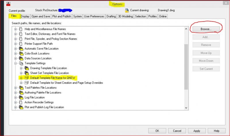

You should set your Default QNEW template to which ever one you want to use, on a daily basis, presumably one for which the Units of Measurement are appropriate right out of the gate. Imperial based templates default to Units INCHES, and Metric based templates default to MMS. Those are the defaults for Vanilla Autocad, and I believe that in some of the Autocad Vertical products, they may be different.
You can do that in OPTIONS > TEMPLATES, as shown in the screenshot, just click on the Default QNEW Template, then use BROWSE to specify which template you want to use as your default.

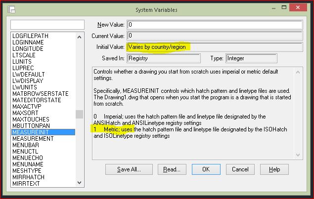

Here is another interesting bit of the puzzle for you to consider.

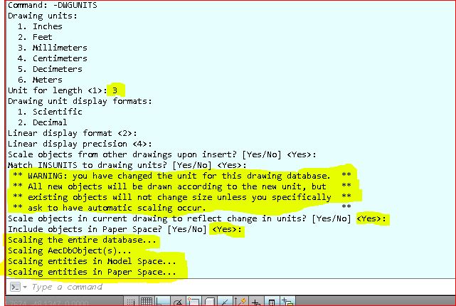

When using the -DWGUNITS command, I recommend expanding the size of your commandline history, so you can see multiple lines at one time.
It sounds like you may have failed to confirm the rescaling of modelspace and paperspace, or else I think you should have been fine.
For me, the real beauty of the -DWGUNITS command is that it brings a number of different commands or variables all under the same roof, so that they are working in concert. Typically when receiving a new drawing I will run it, to ensure that all is as it should be, beforing starting to work with it. There are lots of folks who assume that they are drawing "whatever they think it is", despite the software having a different opinion. :beer:

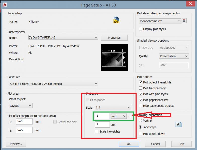

Well, the plot scale units that I showed don't change the drawing units. The plot units only apply to the paper (space) in that one layout, so changing that to mm's only means the paper is measured in mm's, not modelspace. That can really throw the intended scale out the window.
It appears that changing to the acadiso.dwt (metric) from the (apparent) acad.dwt (imperial) has set you straight.
