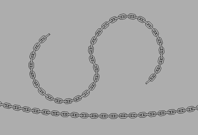

I have never really researched this but does anyone know of a method or LISP code which would allow me to enter two points and have an arc slung between them that would look like a chain. I'd like to have the line have a slight catenary curve to it. I've tried using some blocks for this but it just gets to complex. Then someone suggested creating a new linetype which would handle it. ??? I've not worked with new linetypes before but I guess now is a good time to start.
Do you have an example of how you want the chain to look?
What type of Chain? Roller, Engineered, Lifting, etc.?
There are some linetypes for chains around, I have some for Lifting type link chains I got from somewhere a while ago, easy enough to create with a shape file.

These lines made using the command Measure and two blocks kindly supplied by Jeffrey P Sanders.
+1
Nice idea to chain blocks together (pun intended) I often use this method with blocks, never actually thought of using the measure command multiple times to create more complex designs. I'm sure I'll use this soon.
I found this years ago and thought it would come in handy if I ever needed to use it. That hasn't happened. (Until I got to share it here!)
I hope you can use it and it does what you want it to do. You'll just have to supply your own chain linetype or the linked blocks method supplied elsewhere.
