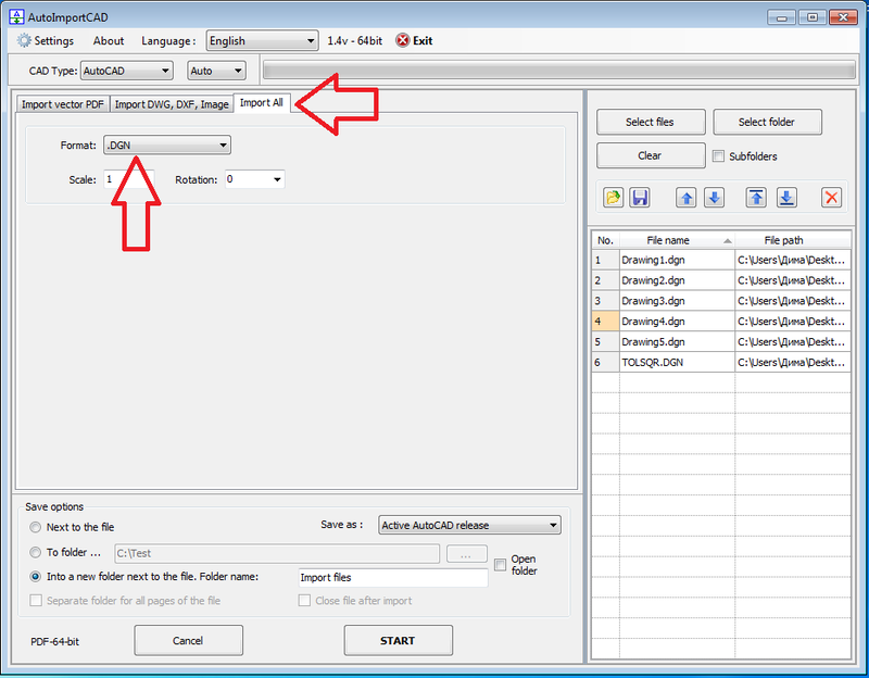

maratovich Posted October 14, 2020 Posted October 14, 2020 Try using this: AutoImportCADMaybe it will be convenient. Quote
