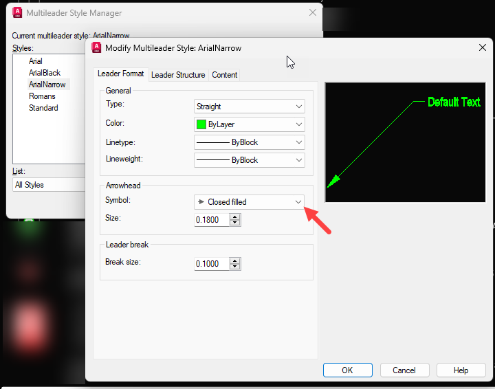

How do I set the leader arrowhead type to "Closed Filled". Can't seem to figure a way out since it's technically just a Solid not a named block in the drawing

Figured it out.
I used :
 (vla-put-arrowheadtype obj 0)

IMO, A better way to manage this is with the MLEADERSTYLE.

I'd rather not use a different mleader style for every leader type i use. I basically just toggle between closed filled and dot blank for any of my styles
OK .. so you'd have two styles then ? Why not use the program as it was designed? If you have a template this is easy peasy.

I have 9 distinct multileader styles that are all used for various reasons. Each of those styles can potentially use 1-3 different leader arrowhead styles. I dont want to muddy up my styles having 27+ styles just so I can have a different style for each arrowhead.
In my opinion, I am using the program as intended. I'm using lisp to create a workflow that fits my specific needs to reduce tedium and time.
